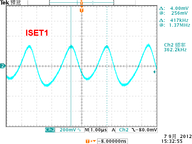

Question 1 ( about C7):
It shows that C7 may be needed for programmed charging current less that 0.3A in bq24030's EVM user's guide
and I set charging current to be 75mA in my board,
but could you please tell me why we may need C7?
What is the C7 function in this circuit?
Question 2 ( about ISET1):
Here is the ISET1 waveform,
and it is not a DC voltage but seems like a sine waveform,
could anyone explain the reason for that?
Thank you very much for your support!
