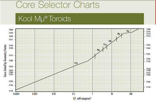

  • Sam,
    I think that core is way too small (cm right?). Attached is a size chart from magnetics inc (http://www.mag-inc.com/) that will get you close in size. The current you use is your peak current. This is a different material - the one I use on most toroidal PFCs.
  • Hi Kevin.
    Thanks for the replay, yes dimensions are in CM. in reality I want a small inductor in order to meet PCB size, is it possible to use 2 stacked cores from the one I am using?
    I am able to draw 1150W from my PFC, I understand that the size is small, I have seen the size of the inductor for the 350W PFC in the AN.
    I would be grateful if you suggest me a core from those to order.
    How do I make sure if the inductor is causing problems into my PFC?
    Because it works just fine.
    one thing, do you have any suggested PCB layout to start with?
    Please advice
    Sami
