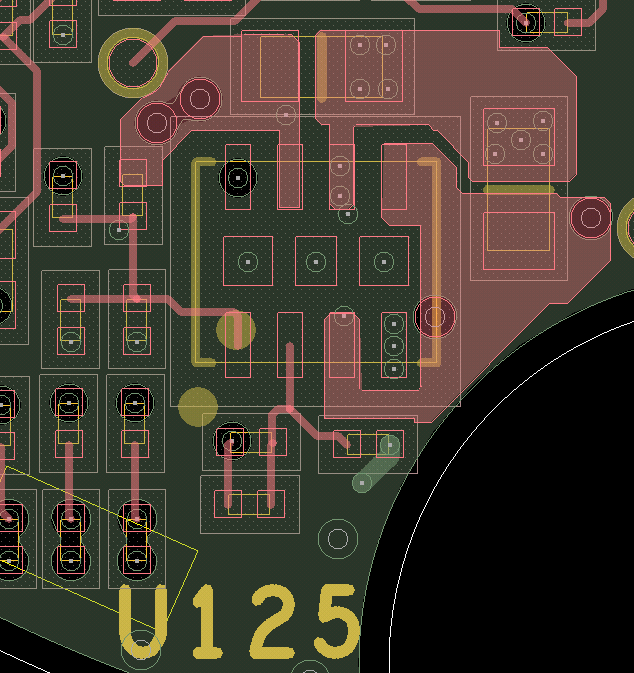

I am having a recuring issue using the LMZ10500 in two locations on a prototype PCB.  Can you help determine why these parts are being damaged and assist us in fixing them?
U125 is setup to generate 2.8V and U124 is setup to generate 3.3V.
1) In the case of U125 the part fails at almost 100% immediately after intial power up.  The failure exhibits the following:
  • Vref  pin is not reaching 2.35v.
  • VREF pin is hovering at around 0.3V output wanders around 0.7 to 1.5V
  • Vcon pin is 0v.
  • Part is getting hot.
  • The part fails again after replacement.
  • We replaced this part with an LDO as a stop gap work around and this works fine.
  • I have lots of failed parts that could be tested if that helps.

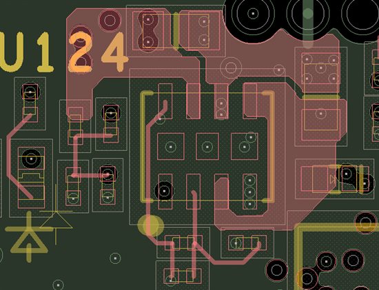

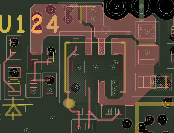

2) In the case of U124 the part fails after many hours of operation
  • In general the part is hot and the output is 1.8V or so.
  • I don't have the failed parts in hand at the moment for other measurements.
  • The primary difference in the configuration of this regulator is that it has a diode on the output as per the design recommendation of the the TMS320DM368 which this is powering.
  • When replaced it will operate from days to weeks with no issue.
  • We are investigating an LDO replacement.

U124 Layout
U125 Layout
Thanks for the help in advance!

  • Hello Jason,
    Thank you for the detailed description, schematic, and board layout snapshot.
    Here are a few more questions to help us start debugging.
    1. Do you have any scope shots across the input voltage terminals of U124 and U125 as the input rail is ramping up to 5V? Also, it would help to monitor what the EN pin voltage looks like during the startup sequence. I am hoping to rule out any overshoot/oscillation above the abs max input voltage and also on EN voltage with respect to VIN.
    2. If you look at the bad units under magnification, do you see any physical damage to the die on top of U124 and U125? I am hoping to rule out damage done during assembly/handling.
    3. You mention the units are running hot. Is this at room temperature? What is the maximum load on each of the two rails and what is the overall board size? Is the ground plane layer in the board layout on the bottom layer or internal layer? I am trying to get a feeling for the expected (normal) junction temperature for this design.
    4. Could you take a picture of the assembled board and attach it? It can be just the section shown in the board layout shapshot you provided.
    Thank you for the clarification on the C473/4 cap placement. Yes, these should be connected from the VCON pin to GND.
    Denislav

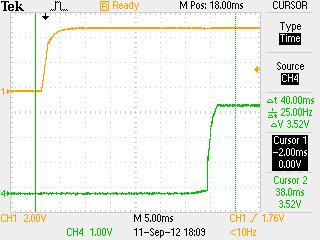

    1) Overshoot: I am having the scope shots ordered up so that it is easily shown on one shot.  I have other shots and haven't seen any overshoot.  The regulator is fed through a FET softstart circuit.  I have recently made a change in the enable for the first regulator in the startup sequence to delay enable until after the softstart time is complete as the softstart action was causing oscillation in the first regulators PG output.
    a)  Basically 5V from USB through a FET sofstart comes up in about a 20ms monotonic ramp with no peaking and feeds these parts.  Nominal is 4.5 to 5.5V as per USB specs.
    b)  The enable comes from the 1.8V regulator and remains low the entire time until the 1.8V power good is released about 5ms later.  This PG has a weak pullup to 1.8V which is probably not necessary.

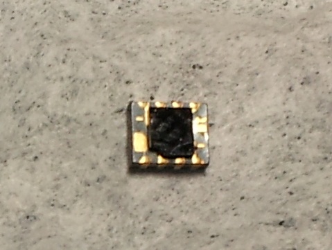

    2) Damage:  I have found units with Damage including the latest one received on Saturday SN009 had damage shown below.
    a) See below assembly as well U124 is on the left of the board before removal.  U125 location is on the right but has been replaced by an LDO.
    b) I have recectly become aware of the mounting and rework guidelines for these parts and have communicated them to our manufacturing folks.

  • Hi Jason,
    The bad unit shown above has severe physical damage. The question is whether the damage occurred during removal of the unit or initially during assembly. Please inspect some "freshly" assembled boards to see whether the assembly house needs to make adjustments.

    The damage was apparent prior to removal from the board but it is hard to say if this happened after assembly.  I am now taking precautions on both sides and we will put a peice of kapton tape over the part to protect it after assembly or rework.  The updated assembly guidelines have been sent to our manufacturing folks so hopefully that will take care of the other side.
    This part is one of the tallest in the location so when debugging the board with this part facing down there is risk of damage so I am hoping the kapton tape will help alleviate some of the problems.

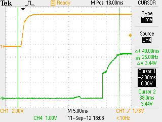

    Here is the scope shots that you requested earlier:
    2)  The scope shot below shows the 5V input in orange to the board versus the Enable to the part in question U124 in green.
    3) The scope shot below shows the 5V input in orange to the board versus the Output to the part in question U124 in green.
