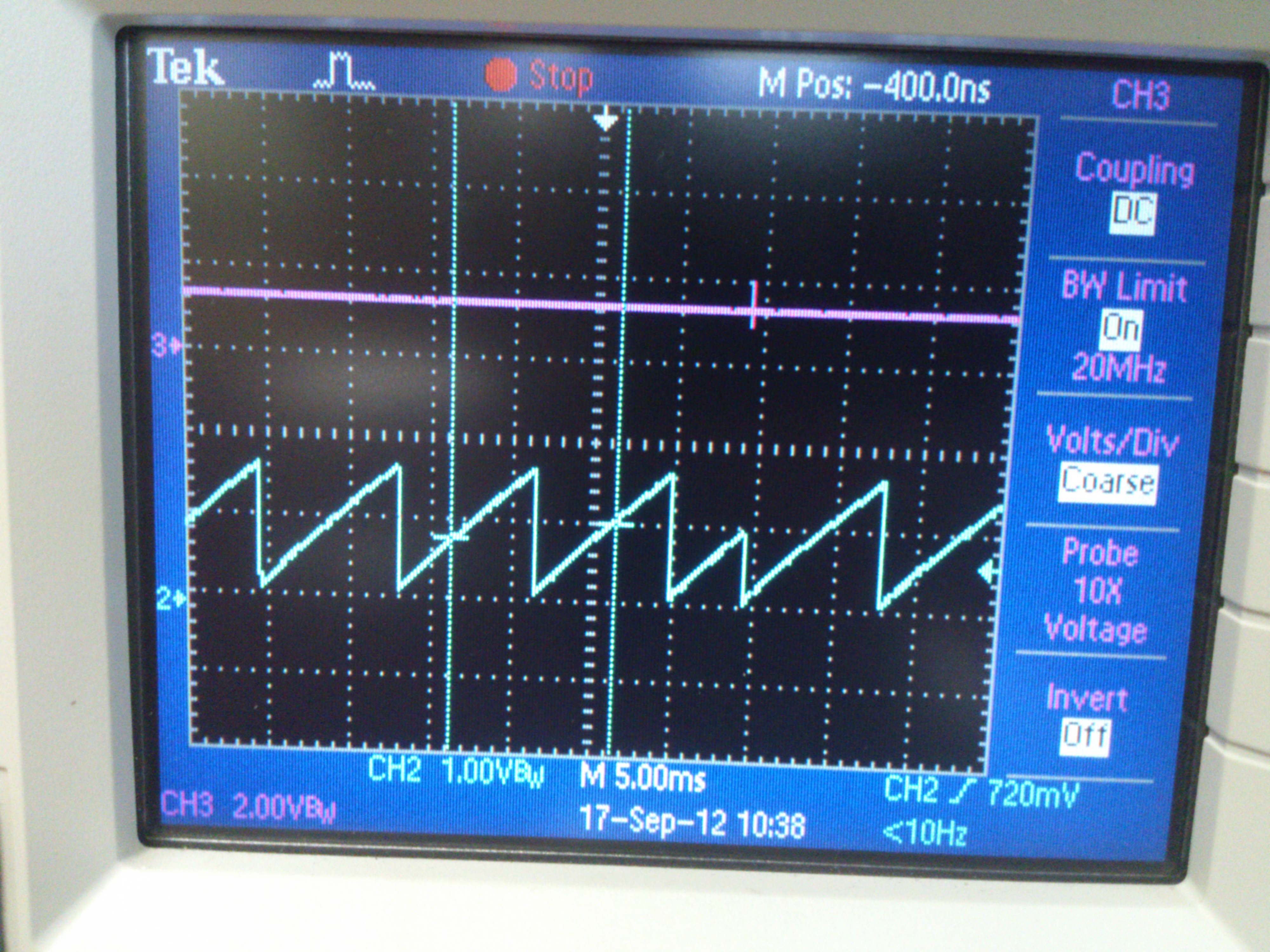

  • Hi Na,
    I have attached the schematics and the screen shots of SS and SW pins. The SS pin shows that it is switching ON and OFF continuously.

  • Hi Sharath,
    From the waveform, the TPS40054 is in hiccup mode for overcurrent protection. Since the ILIM resistor is designed for much higher overcurrent trip point, it is likely the OCP is tripped due to excessive ringing on SW node. By reviewing the schematic, I think there are something you could improve.
    (1) Add some 10uF or 22uF ceramic capacitors in parallel with the 100uF bulk (electrolytic) cap at the input. These input capacitors carry the pulsating current and need to have high RMS current rating. With a single electrolytic cap, the ESR is relatively large and the thermal stress on the cap will make it worn out easily. As the effective input capacitance drops, the ringing on the SW node will also get severe.
    (2) The 6.8-ohm snubber resistor (R2) seems a little bit high. The higher the resistance, less effective to lower down the SW spike. You may try to reduce it to 4.7ohm or 3.3ohm or even smaller. Of course if it is too small, then there is little damping and takes longer time for SW ringing to settle down. It will be a trade-off.
    (3) If the problem is still there, you may consider increase the high-side gate resistor R38 or SW resistor R30.
    The layout of PCB is also critical to make the part  part work. For example, the input power loop should be as short as possible. The bypassing capacitors should be close to their respective power and ground. The sensitive analog signal should be kept away from switching node.
    I haven't check the loop design with the extra output capacitance. We have the spreadsheet for loop design which you may use to check your design (http://www.ti.com/litv/zip/sluc263c).
    If you still have problem, please feel free to let me know.
