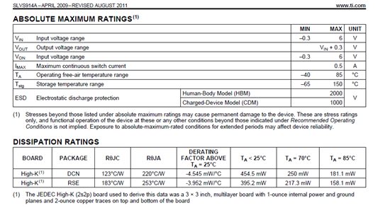

Hi Can you please provide the following information for the TPS22960DCNR Part ?
1. Junction Temperature Max (Tj Max)
 2. Typical Power dissipation (Pd typ)
3. Maximum Power dissipation (Pd max)
4. Thermal Resistance Junction to Ambient (Theta JA
5. Thermal Resistance Junction to Board (Theta JB)
6. Thermal Resistance Junction to Case (Theta JC)
7. Weight

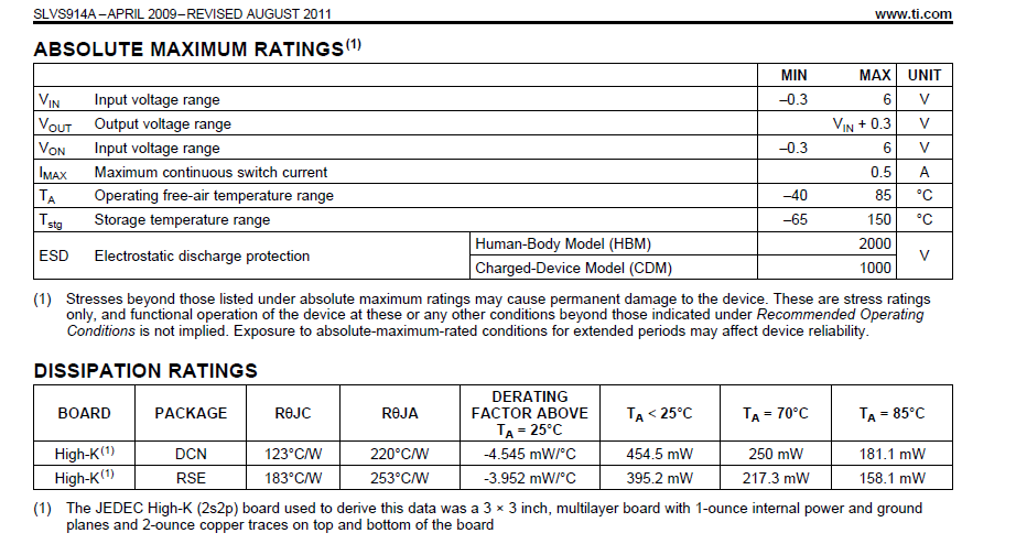

  • Hi Jayakumara,
    This is not a simple switcher product so I am moving this post to a more appropriate category.
    Here is what I could find on the datasheet.
    For more information on thermals read AN-2020: Thermal Design by insight ....
    of go to TI.com/thermal
  • Hi THANKS FOR UR INFORMATION
    BELOW INPUTS ARE NOT AVAIALABLE IN DATASHEET.
    CAN U PLZ PROVIDE FEW MORE INFORMATION FOR THE PART -TPS22960DCNR ?.
    1. Typical Power dissipation, (Pd typ)
    2. Maximum Power dissipation (Pd max)
    3. Junction Temperature Max (Tj Max)
    4. Thermal Resistance Junction to Board (Theta JB)
    5. Weight
