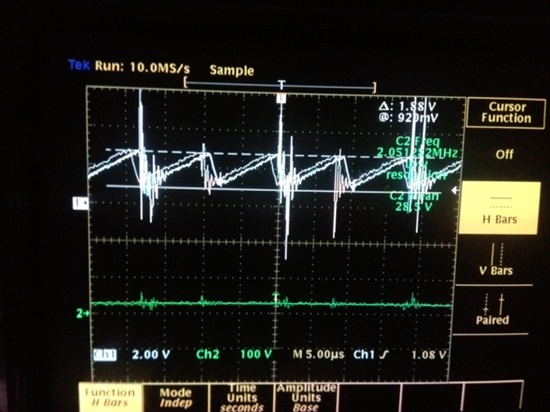

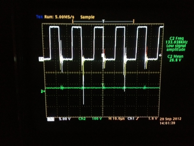

I used UC3823N in my boost converter to work in CCM voltage control mode. However, it turns out that converter works in DCM and output voltage is much below it's designed. I checked the output PWM and Ramp signal on pin 7 as picture below
The white line is output PWM of UC3823N, the green line is output voltage of converter.
The white line is ramp signal of UC3823N, green line is output voltage of converter.
I think it may be the noise that cause my circuit works in DCM,  can anybody help me with this problem?

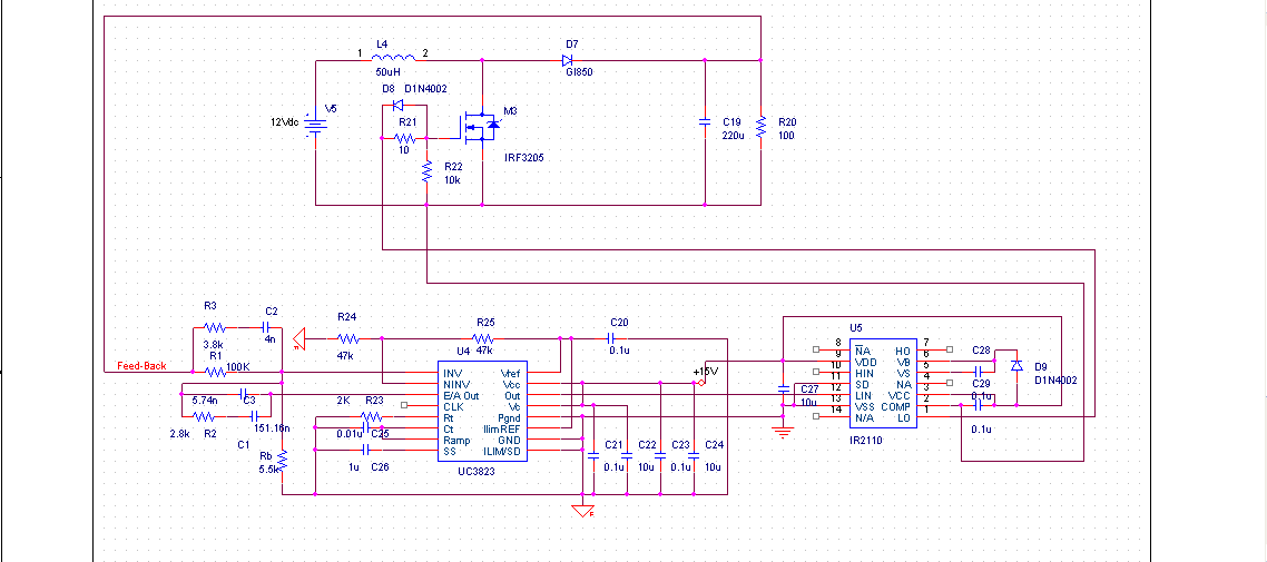

    Thanks for the additional information. Could you provide probe values at some of the pins? specifically the current limit pins (11 and 9) as well as output PWM and output voltage pins etc.
    A schematic would also help trouble shoot the issue as well.
    Rachel
    the below is my circuit schematic

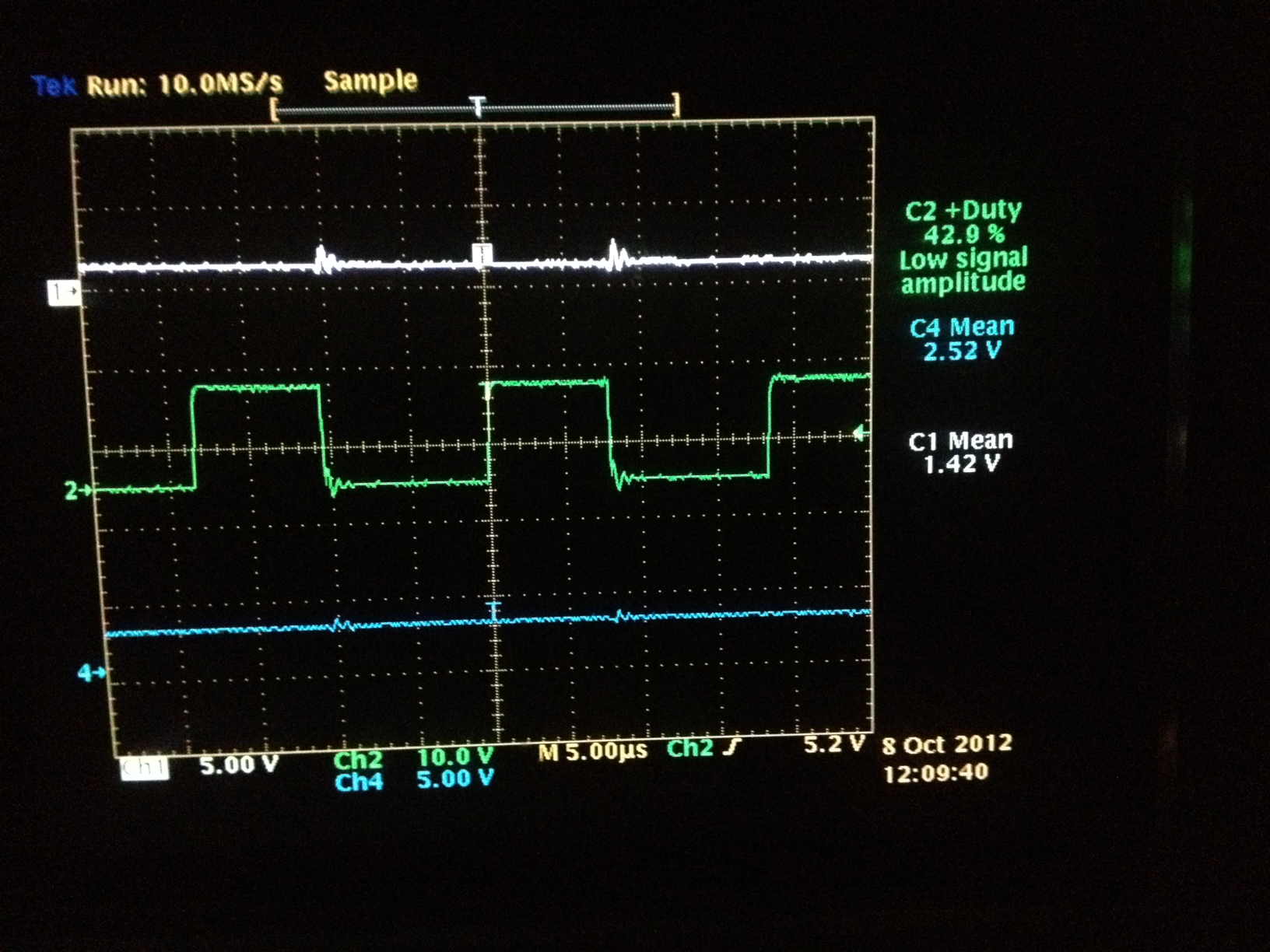

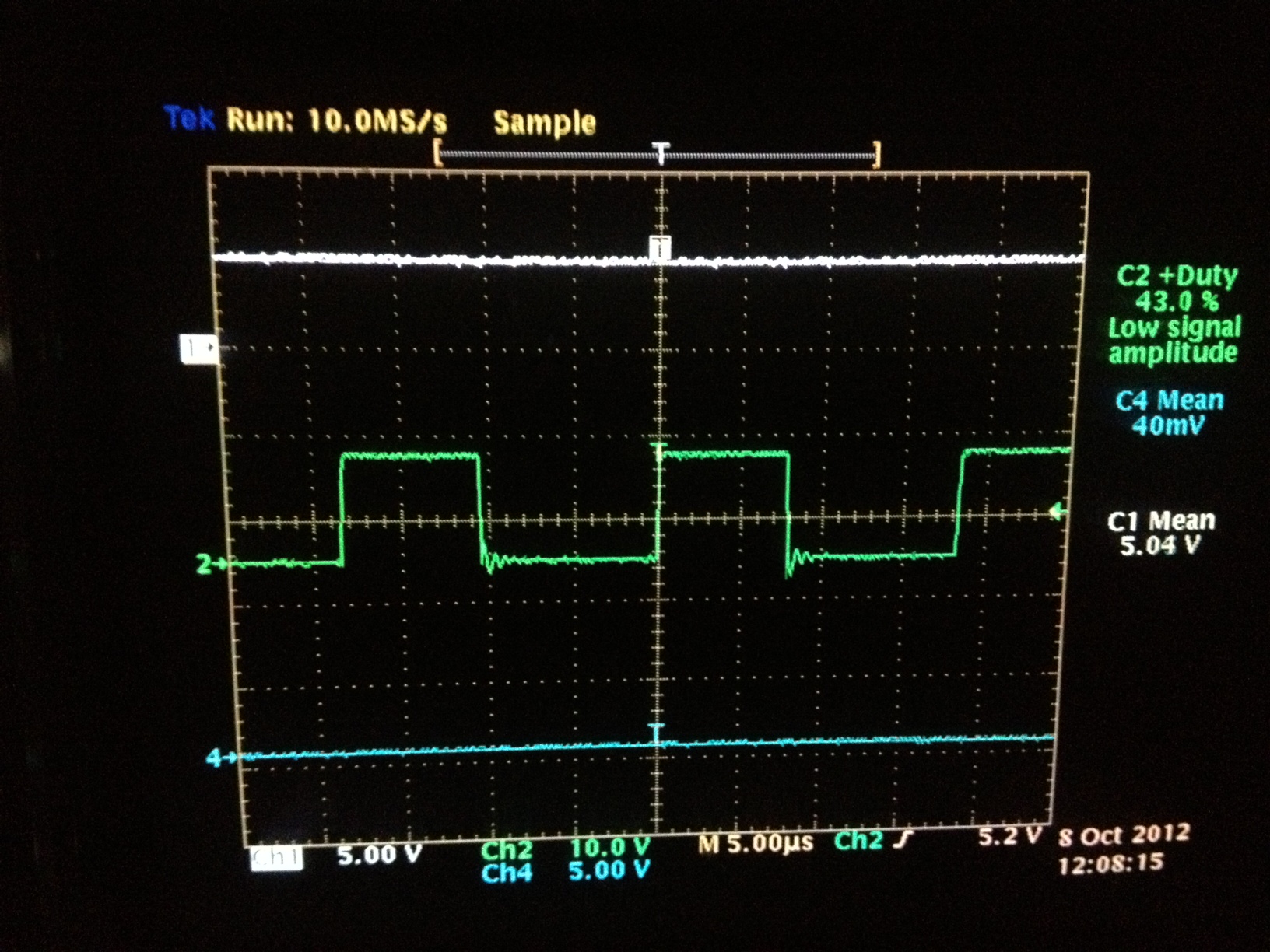

    The next one is probe values
    The white line is pin 11(current limit), which I conneted to Vref(Pin 16, 5.1V). The green line is output PWM. The blue line is pin 9(Ilim/SD) which I connected to ground, because I used voltage mode control.
    The below is pin values of inverter input and noninput of error amplifier
    The white line(1.42V) is feed-back input to pin 1(INV). The green line is output PWM again. The blue line is input to pin2 (N.I.)(2.52V), which is connected to voltage divider(half) of Vref(pin 16, 5.1V).

    My consideration is that the input voltage of INV(pin 1) is much belower that N.I.(pin 2), why doesn't output PWM duty cycle go up? Instead, it stays at 43% duty cycle.
