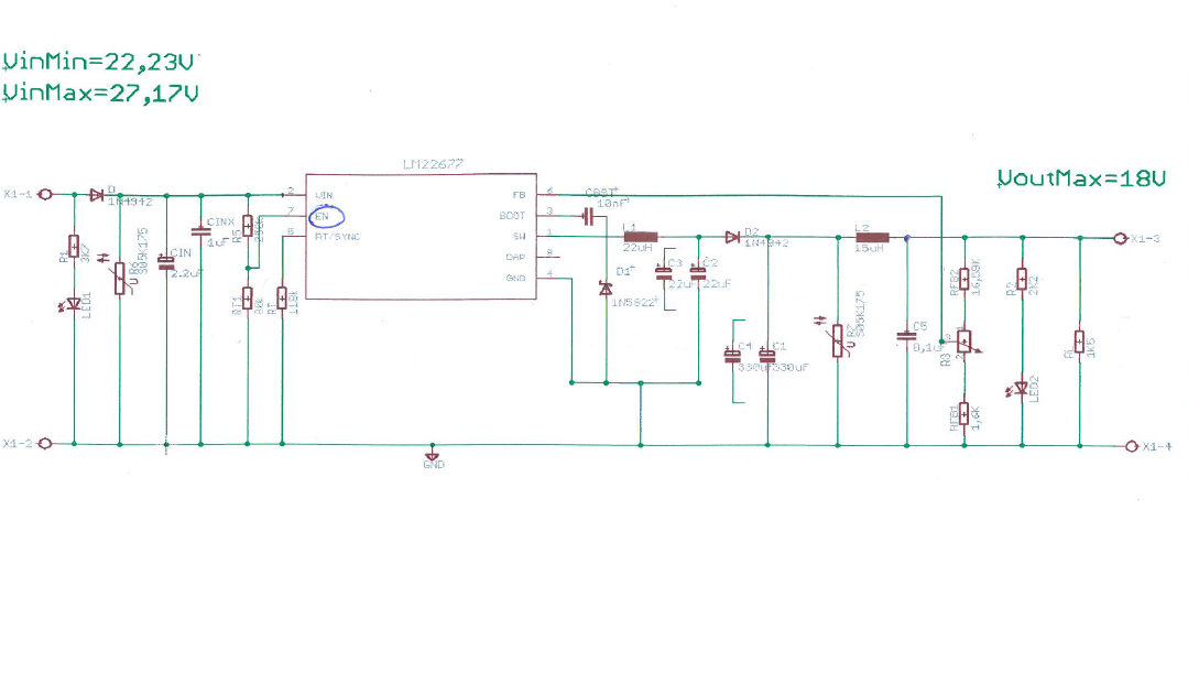

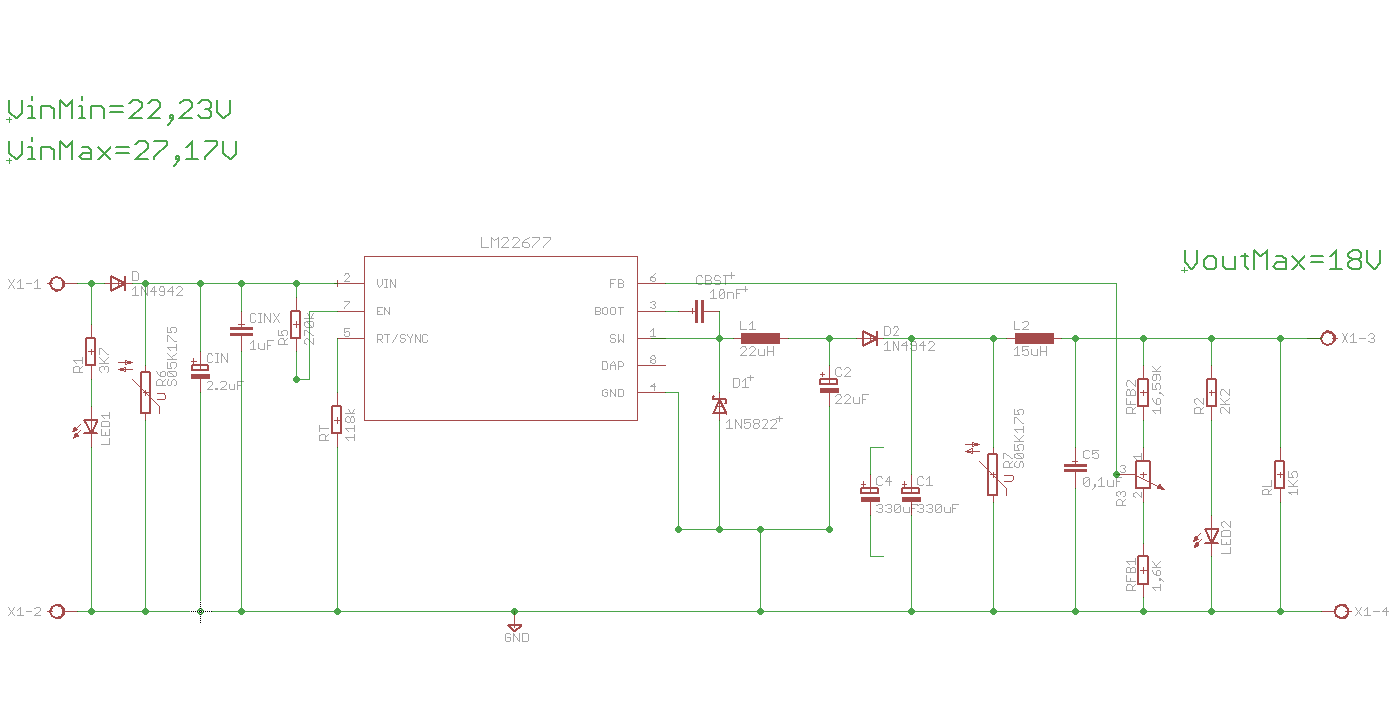

I bought the LM22677 switching regulator from a supplier of your company and I hav built  my board with the help of tools: Webench Design Report.
my data:
Vinmin = 20 V
Vinmax 27 = V
Vout = 18 V
Iout = 2A

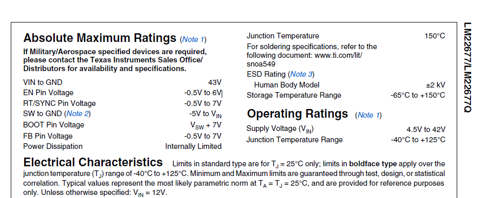

I've found two problems,
first: if  I turn on the switching regulator and after that  i turn it off, then it will break down.
secondly:
  if i wants to use the controlling the switching regulator with Enable pin, I have built between PIN Enable and Vin a resistance value of the 270k, but the same problem I
Can you please explain to me why it broke the LM22677 regulator
