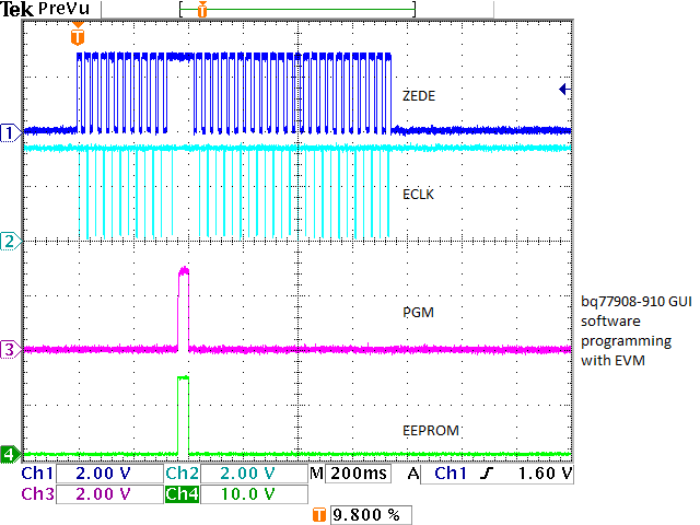

    Now that I have a scope I can see the ECLK rate of about 50kHz, but I am only getting what appears to be only 6 clocks pulse trains of 9 clocks each (3.3V in amplitude), but I would assume I should see at least 10 pulse streams, one for each of the 10 programming values.  The clock pin does appear to be correct (9 clocks), so I believe my header connection is not reversed (odd for even) as I first expected.   The ZD strobe is 43mS in length with an amplitude of 3 volts.  The PGM pin from the USB-TO-GPIO pod does nothing (0 volts continually).   The EDATA trace does appear to be data with the first byte being 0x20 (ASCII space) which does not correspond to any of the data from the file and not the first entry of 0xcc which I may expect unless the protocol has some preamble associated with the data sequence.   If the ninth clock is an ACK, it is high which means NACK if the protocol follows the SM Bus methodology.

  • A scope should help.  If you also have an EVM you might do some signal comparisons.
    The ECLK should be ~ 50KHz as you observed
    ZD and ZEDE should pulse high during the communication.  If ZEDE does not go high the part won't ack. This would show up on the scope.  In the GUI check the status on the bottom left to see if it indicates success or NACK.  Also messages may appear indicating it can't find target or communication lost.
    The update sounds like signals are getting to the board but the sequence stops.
    Certainly check the pinout of the connectors and signals to the IC.  The USB-to-GPIO and EVM board use the industry standard pin layout.  The schematic symbol may be flipped and rotated for convenient signal exit for the symbol and is not meant to be a top side pin view.  Also check for the common assembly shorts/opens/solder/wrong components.
    The bq77908-910 software is not strictly like the datasheet programming flowchart in that it is an evaluation tool.  The registers are written as values are changed.  When the programming command is selected, the volatile registers are read and compared to the GUI values, if they don't match the sequence stops and there is a message box.  (If the part does not respond it should also stop).  If the verification was successful it will continue to write control registers and switch the PGM signal to control the EEPROM voltage.  After the programming the registers are verified. A successful programming sequence with the GUI and EVM looks something like the following
    Check to see if the part is powered.  The USB-to-GPIO provides pullups from its power supply, so presence of signals does not indicate the '908 is on or working. Also be sure the CHGST pin is held high during the programming cycle, it is not provided by the USB-to-GPIO.  If the part shuts down between the volatile register write and the programming command the register value match warning should appear, if it shuts down during the programming an unsuccessful programming message should appear.
    The GUI error messages are meant to be descriptive and may give guidance as to whether there is a basic communication problem, a data verification problem or a lack of verification after programming.  The description yesterday sounded like the part talked initially then failed to verify after programming.  If this is the case check for shorted/missing PGM, 14V supply and ground, or poor rise time or droop of the EEPROM signal/switch.
  • Programming is sucessful!!!   Thanks!!!!   The "gotcha" was that I did not have the CHGST pin pulled to PACK+ via a 15K resistor during programming.  The programming instruction (SLUA648–July 2012) indicates "Before running software, some hardware connections must be made to assure the necessary signal can be applied to the specific pins of bq77910 or bq77908 from the USB-TO-GPIO tool kit, for details on which signal should connected, refer to schematic of bq77910EVM in document  sluu368."   The required connection to CHGST is lost in the schematic, but for future releases a reference to Figure 3 would be helpful.
