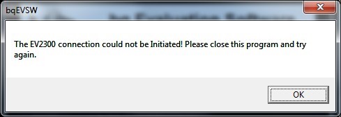

  • Hi all.
    I'm using computer with installed 64-bit windows 7.
    1) I've successfully installed driver EV2300a_Device_Driver_Installer_Multilanguage_0.6 downloaded from the link above.
    2) After plugging in EV2300 module, installing new device notification passed twice successfully.
    3) Installation of bq sw bqEV-EasySWSetup00.09.41_bq20z95v1.50_bqEasy1.50 that comes with purchased kit passed successfully too.
    But when I connect EV2300 module and run bq Evaluation Software, I get this message:
    (Also, bq Evaluation Software start up window shows sw version 0.9.41)

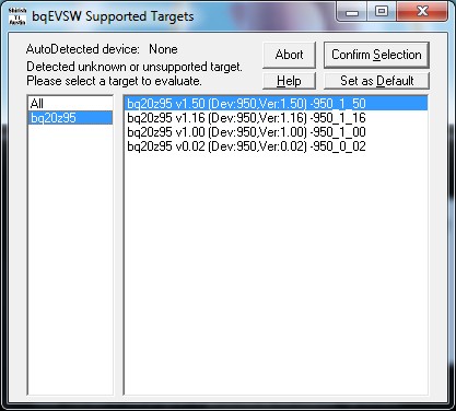

    When I click OK, this window appears:

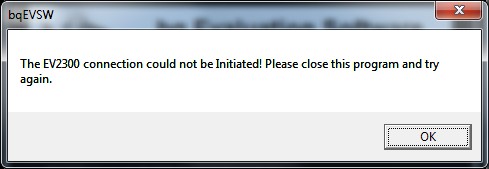

    I tried out all of these versions. In any case these two windows pops up:
    Please advise!
    Ivica
  • This seems to be the solution (works on two 64-bit Win7 machines):
    1) Install driver EV2300a_Device_Driver_Installer_Multilanguage_0.6
    2) Plug in EV2300 module to USB port and wait for windows to install device showing message "TI TUSB3210/2136 App Fw device installed"
    3) Plug out EV2300 module
    4) Install bqEVSWSetup00.09.59_bq20z95v1.50_bqEasy1.85 downloaded from this link
    http://www.ti.com/tool/bq20z95evm-001
    5) Connect custom battery pack with its bq control board or test adapter board to the EV2300 (follow instructions in case of test adapter board)
    6) Connect EV2300 to PC and run bq easy software.
    Ivica
