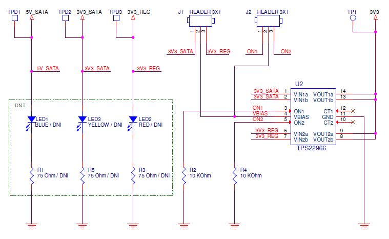

Hi TIers,

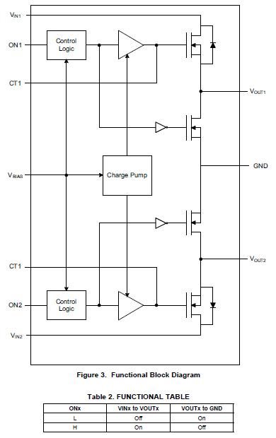

From functional block diagram, output connects to ground when switched off. (Datasheet page 6)
Problem is that in my circuit, I’m  switching between two power inputs.
The connection to ground will short my other output.
Using diodes will cause a voltage drop. Anyway we can resolve this?
