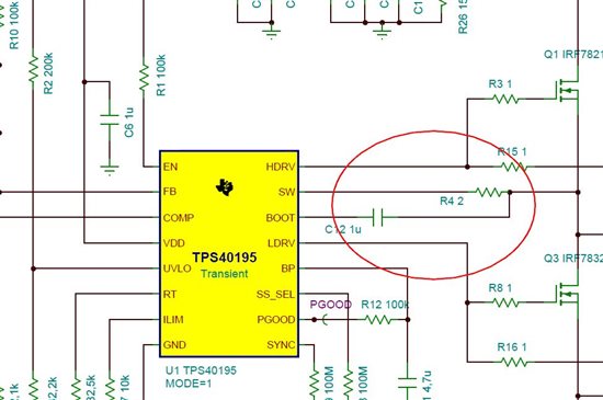

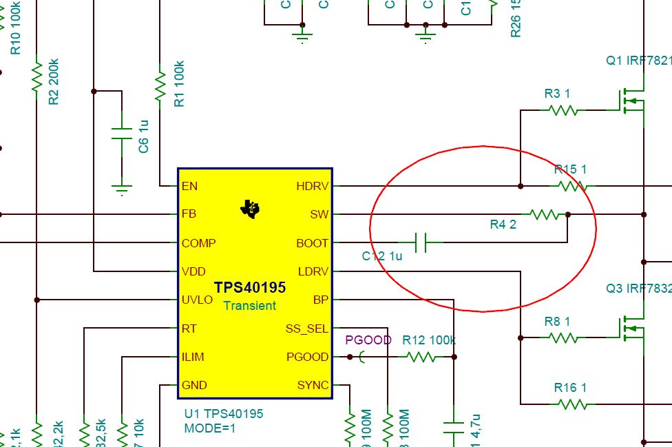

where is the right position for R4?

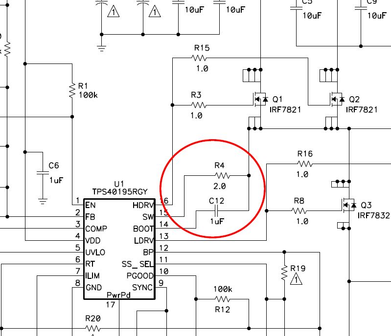

In Tina TI an The User Guide for the TPS40195EVM R4 is parallel to CBoost:

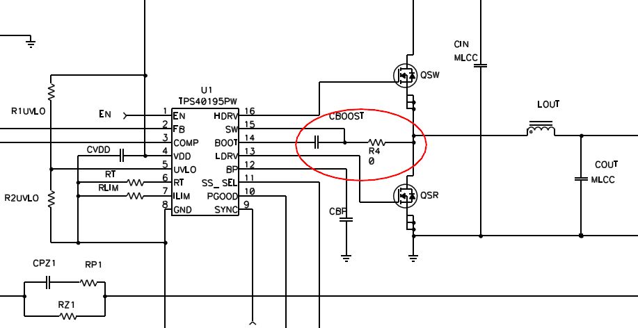

In datasheet R4 is serial to CBoost:
What's right?

  • the right connection, regarless the controller, is to have
    BOOT / C12 / R4 / SW
    connected in serie...
    the reason is that the R4 helps reducing the switching current (acts like a gate resistor in both turn on / off processes of the high-side power FET)...
    in brief, it work like a resistor between pin 16 and HS_gate...
    V.

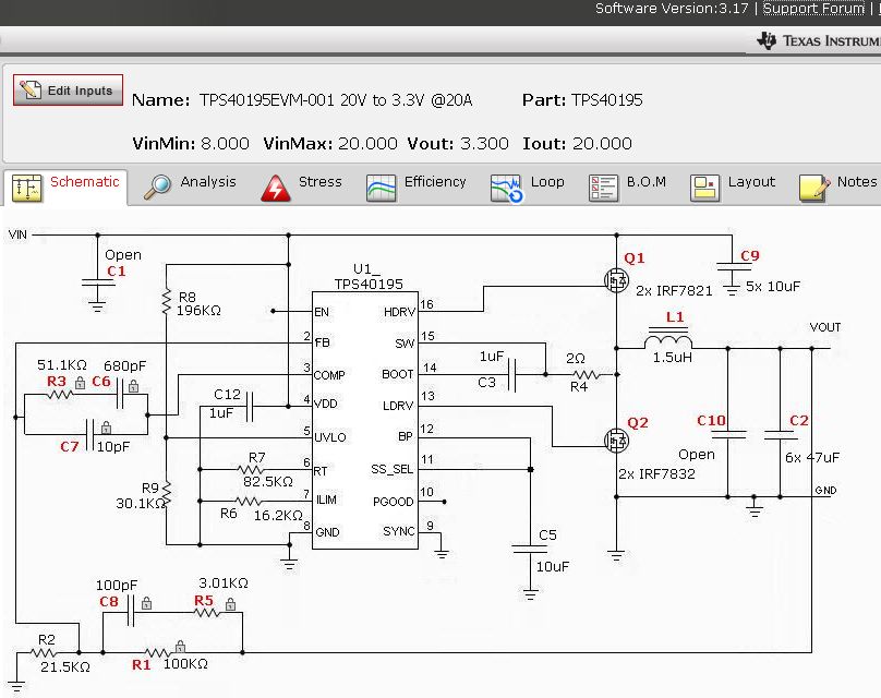

  • ok, then it seems SwitcherPro is also wrong:
    Will this be corrected in a newer version?
    Also R4 is stated in B.O.M. of SwitcherPro as 2W resistor with 2512 package.
    In the EVM R4 is a 63mW with 0402 package.
    Which package will be sufficient?

  • Dear Sir,
    I am a college of the the previous requester akircan and I  would like to know which schematic is correct.
    In the moment akircan and I assume  that the connections of R4 and C12 to TPS40195 and to all  MOS-FET
    in the following schematic part from the TPS49195EVM User Guide  is correct
    Do you agree?
