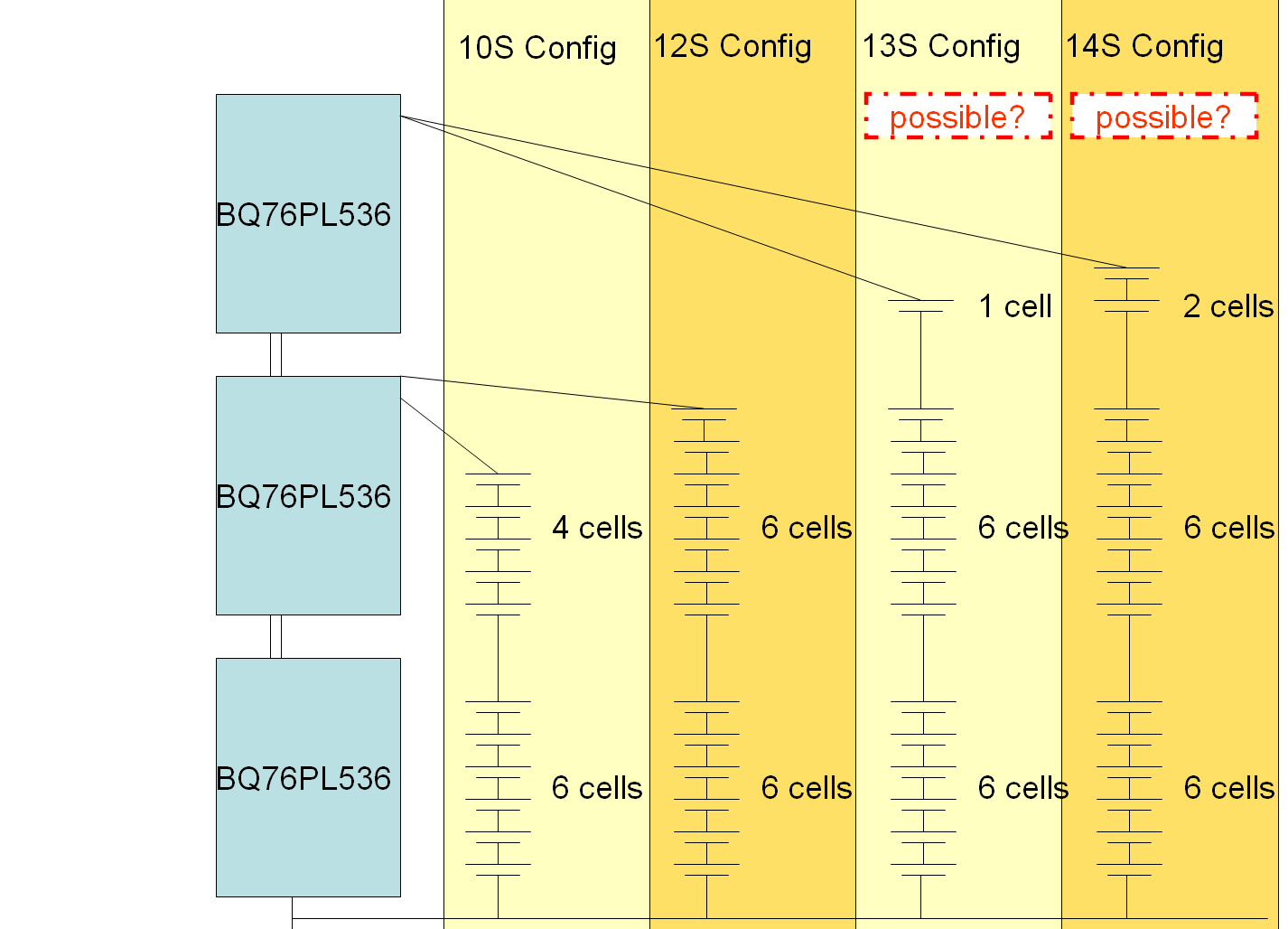

Dear Engineers,
we're working on a flexible BMS solution with a cell count reaching from 10S to 14S (with a stack of 3 bq76PL536). We just received the evaluation board, but before connecting cells to it, I need to know how to distribute the cells. The datasheet sais bq76PL536 is made for 3 to 6 cells.
Does that mean, let's say for a 13S configuration, I have to have a 4 - 4 - 5 or a 6 - 4 - 3 configuration (or such similar patterns). Or can I just straight forward connect 6 cells to lower bq76PL536, 6 cells to the middle bq76PL536, and 1 cell to the top bq76PL536?
Thanks and best regards,
