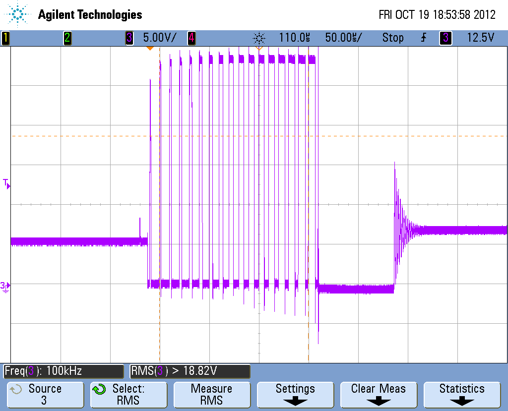

Hi All,

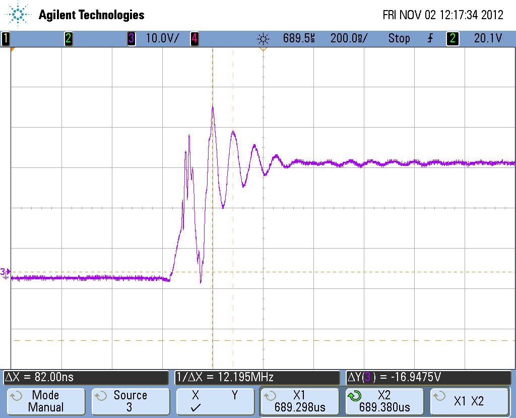

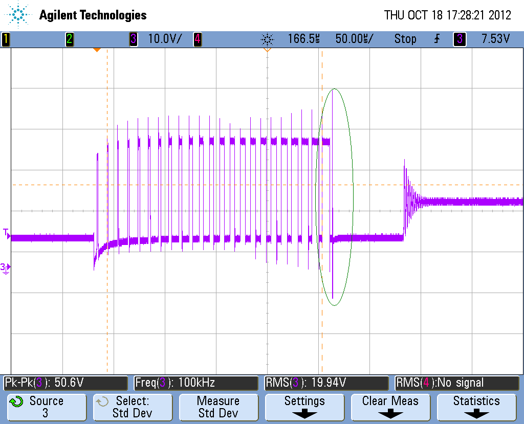

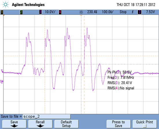

I am using TPS40170 in my buck converter. Input 18-32 V, Output - 15V, Max current - 4A. When I observed the SS capacitor, it is found that the voltage switches between 2.5V and 300mV, indicating that there could be some fault condition(Temperature, OCP and SCP), As I have not connected any load, OCP and SCP cannot happen. Even the device is found to be very cool which concludes that there is no over temperature fault. I have left out with, ringing, which causes the scp or ocp condition. I have noticed ringing on the high side gate pulse with a frequency of 8MHz which causes the device to shut down. The ringing occurs when the HIgh side mosfet, switches on, which in turn trigger SCP (as i believe)   The same ringing frequency is seen in boot capacitor also. I am using a boot cap value of 100nF. The MOSFET used was IRF540Z. We have used our own custom board. I have tried all known methods to avoid the condition like adding a series R to boot cap or changing the value of boot cap, addition of snubber circuit at the SW node etc...etc...Kindly anyone help to resolve the issue.

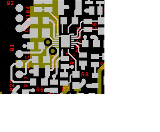

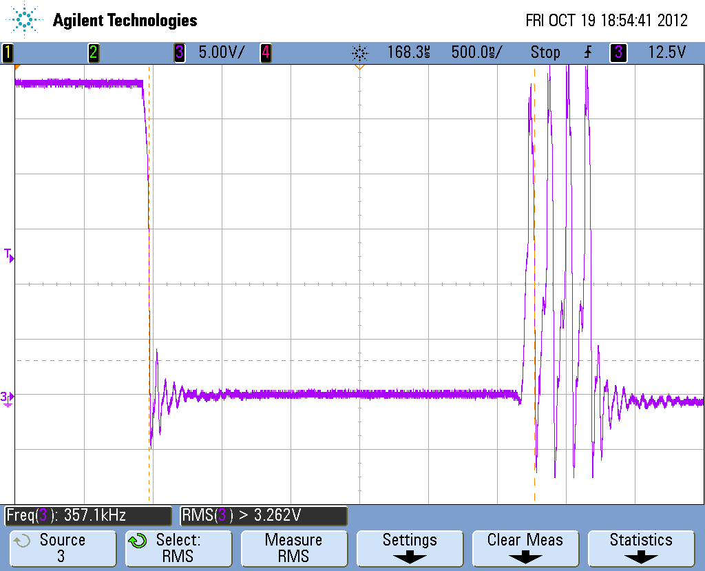

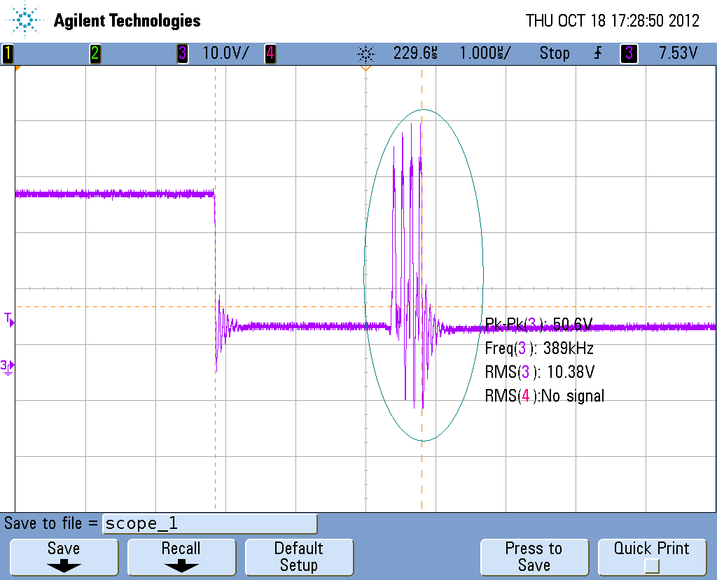

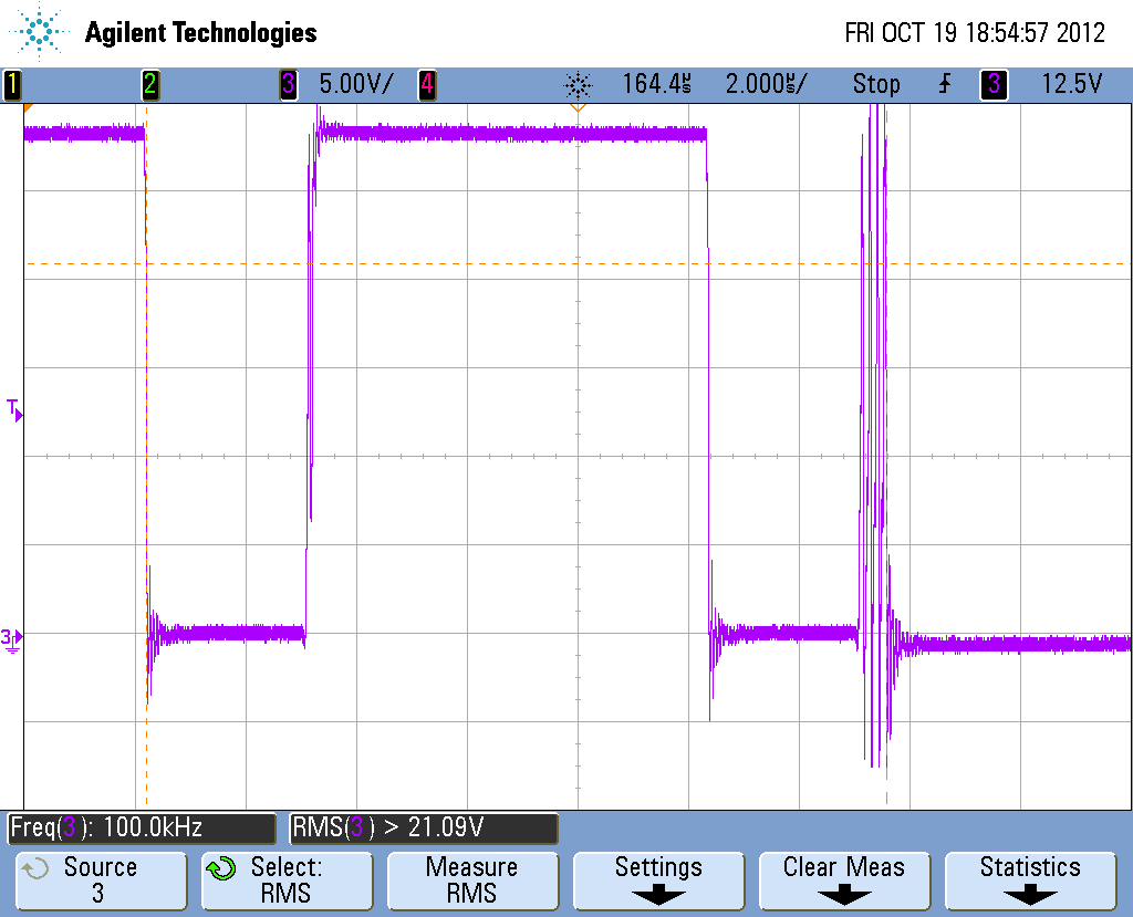

  • Hello Anthony,

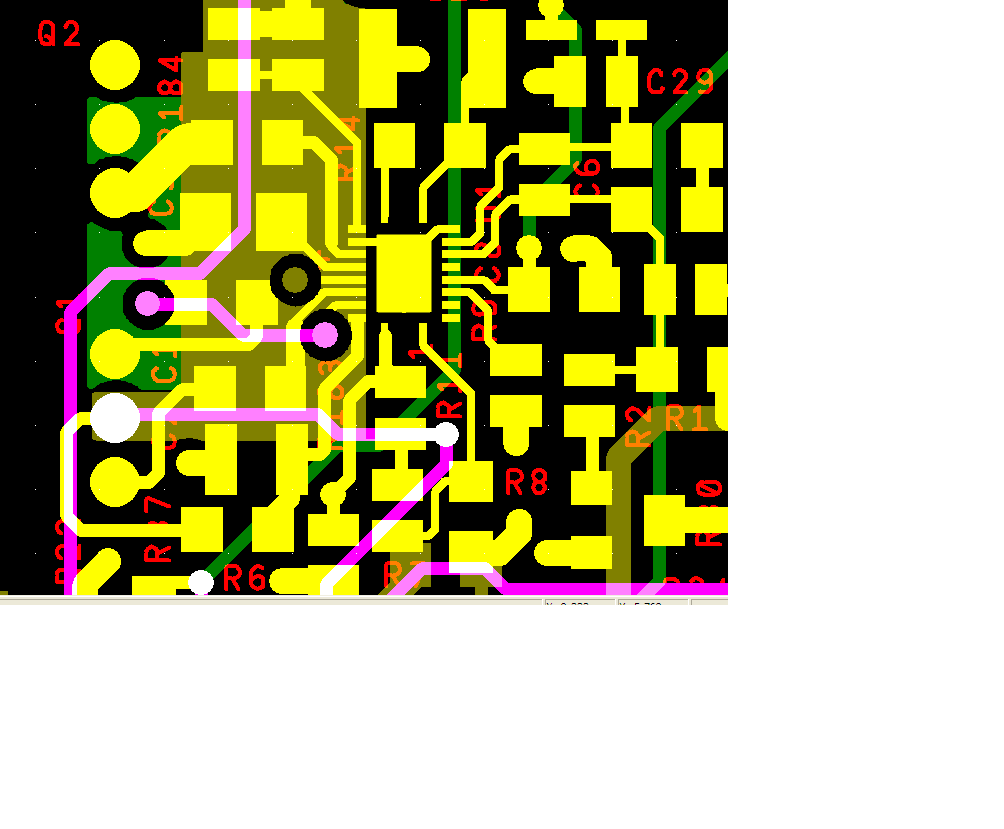

     Thanks for the response. I am attaching the schematic and layout. Also I am attaching the waveforms noticed on the HDRV pin. Kindly note that I have changed RT to have a switching frequency of 100KHz.. Note that the ringing is observed even with 300KHz switching frequency(as per the design in the schematic)

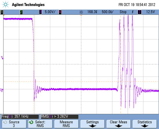

  • Manu, thank you for the detailed information. Judging by the switching waveform you might be running into issues where the boot capacitor is running out of charge for driving the high-side FET. Is there a prebias voltage on the output during turn on? There appears to be one of about 8-9V. Have you or can you test startup with no voltage present?
  • Hi Anthony,
     Thanks for the reply and advice. I am attaching the waveforms with no prebias at the output. We don't have a prebias at the output. As I have not connected any load, the previous charge on the large output cap may be appearing as prebias in the earlier waveforms.
    I have tried by increasing the boot cap, but it didn't resolve the issue.

    -Do you have a layout which shows the copper as well? Make sure all guidelines in the datasheet are followed. I may also be interested in checking out your BOM.

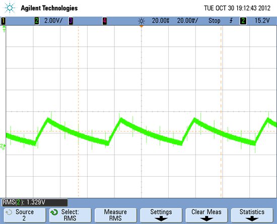

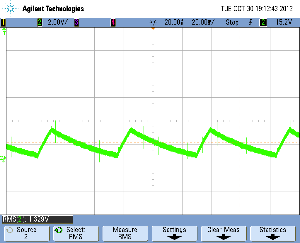

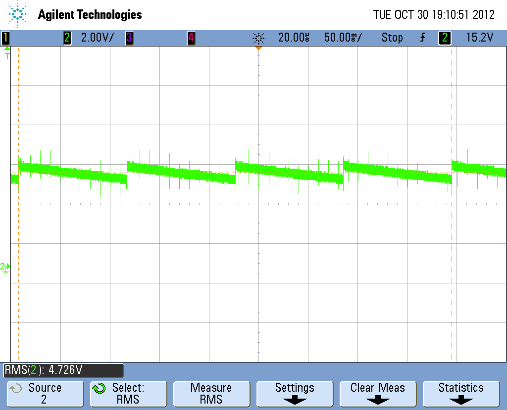

    I am attaching a few more wave forms
    1) VOUT waveform (noticed in the open loop condition)
    2) The waveform at SS pin (open loop)
    Kindly analyze and suggest any improvements if you have

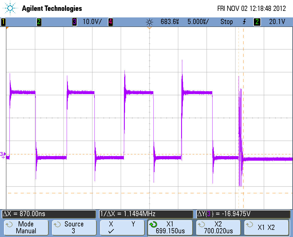

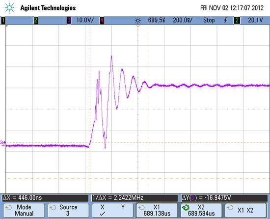

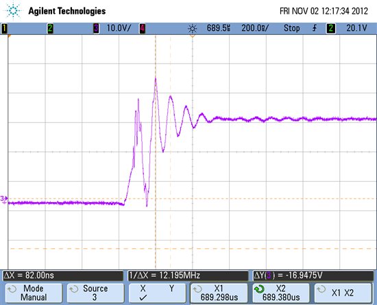

  • Hi Manu,

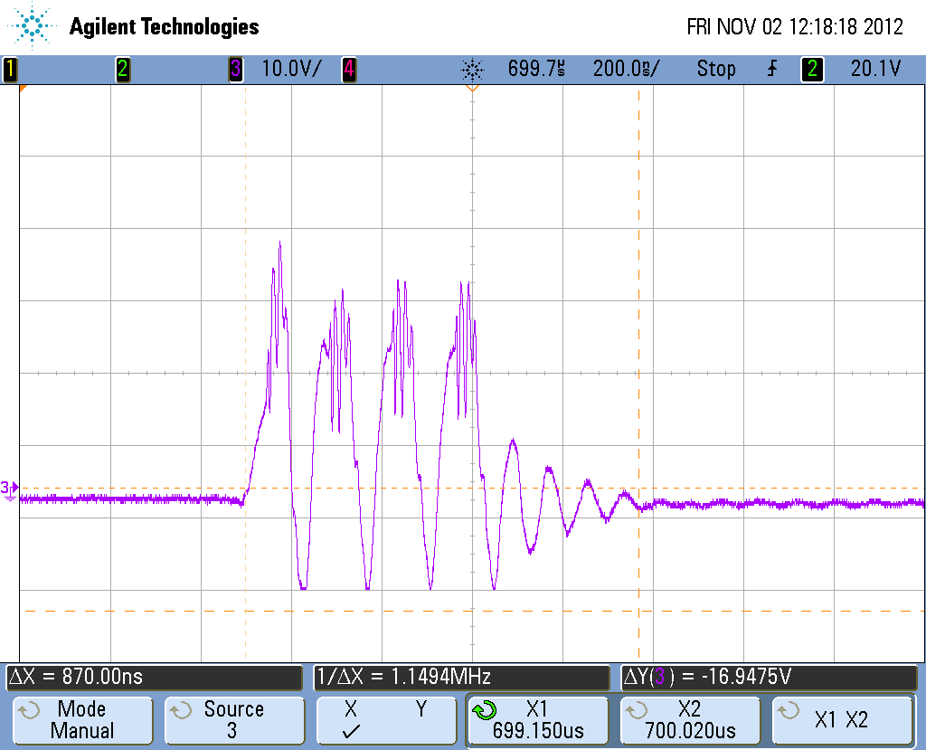

    After looking at your layout again there may be some improvements here to help reduce the ringing during the turn on of the the high-side FET. Can you show a screenshot zoomed in on the rising edge of the last normal pulse seen? I'm curious how long the ringing lasts.
    Can you please post your layout again showing the copper areas and traces as well? I can't make a thorough judgement from only the placement.
    Anthony
  • Hello Anthony,
    I am posting few more inputs as you have requested. The waveforms are captured with the circuit in open loop condition
    Attached below is the zoomed screen shot of rising edge of last normal pulse seen
    As you can notice in the below waveform the ringing lasted for around 870 nS

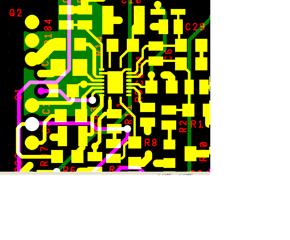

    I am attaching the layout with copper tracks, The layer details are given below
    Total we have 6 layers
    Top layer - Signal routing - Grey/Yellow color
    Second Layer - GND
    Third layer - Signal routing - dark green color
    Fourth layer - signal routing - violet color
    Fifth layer - GND
    bottom layer - signal routing - Olive green color
    1) All layers
    2) All layers excluding bottom side
    3) Top and bottom side layers
    Kindly suggest any other modification if required

  • Hi Manu,
    Took us a bit to get there but I believe the ringing on the rising edge on the last pulse is the main source of the issue. But first let me make sure of the measurement technique here. Was a short GND lead used to minimize the inductive coupling into the probe?
    You will want the largest peaks of the ringing to last about 55ns max. To do this you will want to include what you have already tried plus you may need to improve your layout. Make sure your RC snubber is optimized and use the bootstrap resistor to increase the turn on time of the high-side FET. Although I did ask you to try taking them off and am guessing they were not used in this measurement. I would also keep R6 at zero ohm as this has been known to affect the accuracy of the OCP/SCP trip point.
    Another improvement here will be with your layout. The placement of the input capacitors and the FETs is critical especially when leaded FETs are used. The parasitic inductance of the leads can greatly increase the ringing so the design is challenging with the TPS40170 because it uses Rdson sensing. You may also want to include more ceramic capacitance close to your FET. This should be connected as close as possible from the drain of Q1 to the source of Q2 to minimize parasitics in high frequency current switching path. Can you try placing a 1µF or 2.2µF ceramic here to see if it reduces the ringing?
    Some minor improvements in the trip point may also be seen by making some space to move your VDD and VIN capacitors next to the IC. You could do this by moving your PGOOD resistor further away to bring the VDD capacitor closer to the VDD pin and AGND pin. For the VIN capacitor you can move the UVLO resistors over. Are these two capacitors ceramics as recommended by the datasheet?
