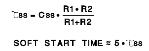

Hi, on UCC2806 there's no specific soft start pin, is it possible to realize this function with external components please ?
UC2846 seems very similar to UCC2806 and we can see page 10 of UC2846 DS an example of soft start function with a simple capacitor in // with resistor divider connected on pin1 (current limit adjust). Is it possible to do it with UCC2806 ?
Moreover in free running mode, saw signal on RT pin is used to generate a slope compensation. But if part used with an external clock on Sync pin, this RT pin does'nt generate saw signal anymore, so how to generate a slope compensation signal ?
