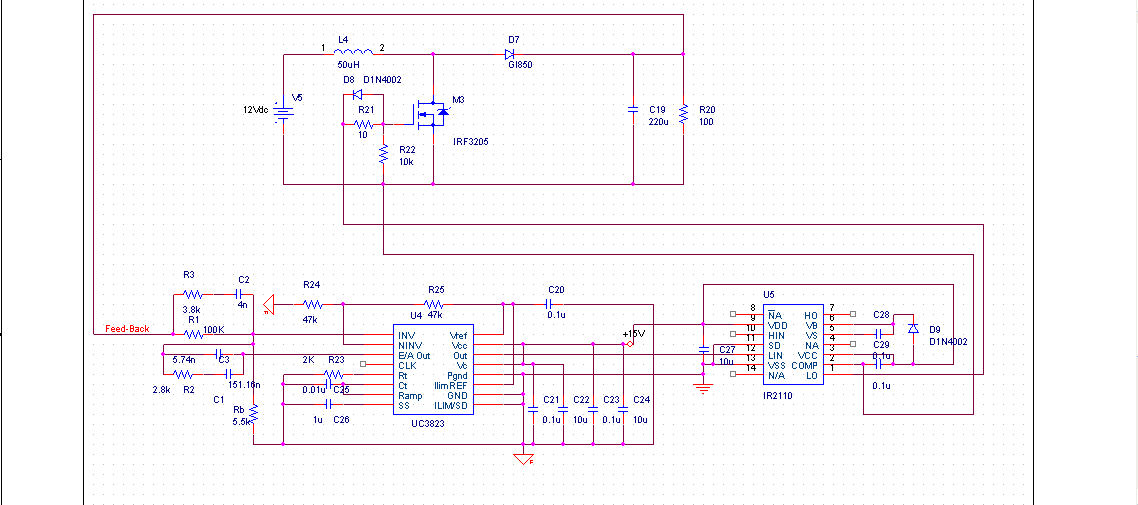

Hi, I designed a boost converter using UC3823N. I got a problem that no matter how adjust parts' values, the converter still works in DCM. If I increase load, the power supply of boost converter would go to current limit and decrease supply voltage(current limit of power supply is 3.2A).
Here are parameters: input voltage 12V, output voltage 48V, PWM duty cycle, output current 2.5A(variable  load). I built my circuit on a breadborad, the following schematic is my design,

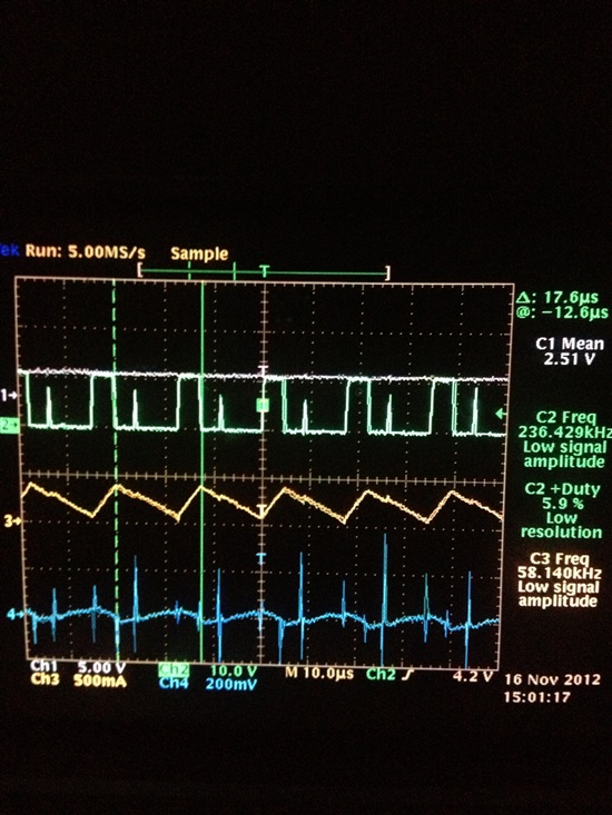

The following picture is some values of pins on UC3823N
The white line in the above picture is output voltage, the green line is output PWM of UC3823N(I know it's weird), the yellow line is input current of boost converter(it's "jumping"). The blue line is voltage on Pin 1(Inv) while the voltage on Pin 2(NI) is one half of reference voltage(pin 16), which is 2.55V.
Another interesting problem is that, if I use potentiometer to increase voltage on pin 1, the output PWM duty cycle would drease, and so does the freqency of PWM. In my design, I choose RT and CT to let UC3823N works at about 100K Hz. If the output duty cycle decreases to 30%, the frequency would also decrease to 50K Hz.

    The schematic I posted is just to check whether the circuit works right. Before this, I used another set of compensator values, here comes the previous schematic
    In this control loop, the compensator has two poles and two zeroes and one pole at origin, I set crossverfrequency at 2K Hz. You mentioned that, closed loop crossover frequency must be at least one decade lower than the frequency of RHP zero. For my example, the RHP zero is at 1.5KHz, the crossover freqency should be less than 150Hz, is this calculation right?

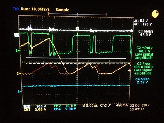

  • Hi, I tried to lower crossover frequency to 1K Hz, however it still works in DCM and output voltage can not reach reqirement. I noticed that the voltage of Pin1 of UC3823N is about 1.7V,  voltage on Pin 2 is 2.5V , voltage on Pin 3 is about 5V. The interesting thing is that the output PWM duty cycle is about 43%. I suppose that the output PWM should be maximum, about 85%, while Pin 3(E/A out) is about 5V.
    Would you help me with that?
    He, Siyu

  • Hi, Paolo.
    I tried current control mode, but the same problem still occures. The following is captured from scilloscope.
    The output voltage is adjusted around 17 V. Ouput PWM duty cycle should be around 30%.When I test it in open loop, the control chip works at 116K Hz frequency.
    The data in the image above is collected when circuit works in closed loop. The problem is that output PWM composed a wide pulse about 4.8 us(about 55.81% duty cycle based on 116K Hz) and a spike with same magnitude of pulse. I believe this spike is the initial of a sequence PWM.
    I am wondering why can't PWM output be 30% duty cycle for each periode?
    The bottom line (blue) is the voltage of current sense? Why it does not follow the ramp of input current which is in yellow in above image?
