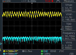

I'm using the evaluation board for the LM5117 and changed some components to these values with the help from WEBench and the excel calculator. I kept the other components as is. I'm trying to optimize the circuit to output 12V at max current of 2A, from input voltage of 36V to 60V.
L1 - 47uH, DO5040H-473MLB, Coilcraft as recommended by webench
C15 - 47uF, 55 mohm
R3 - 54.9k
R4 - 2.32k
R9 - 30k
C8 - 18nF
C19 - 56pF
I observed that when I use my electronic load to increase the current drawn from the DC-DC regulator from 0A to 2A, there is a huge output current ripple (400mA) at around 500mA output, see below scopeshot. I probed the CM output using my voltage probe as I do not have a current probe at hand. The ripple is only observable from 300mA to 500mA range. Once outside this range, the ripples are not noticeable.
Ch1 - Voltage output
Ch2 -  Voltage output of CM (via J5 connector)
Input voltage: 48V
I've tried varying the output capacitance but to no avail though at low cap value, the output voltage has a noticeable ripple of 200mV but as I increased the cap, it lowers down to about 100mV but the current ripple is still there. I thought it could be the compensation circuit but I followed the excel correctly. Could you throw some ideas on what could cause this ripple and what are the things I can do about it?
Thanks in advance!

  • Hi
    Loos like it is unstable. Please try R9=4k, C8=100n and C19=470p. I  assume R17=4.99k.
    Eric

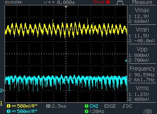

  • Hi Eric,
    The result got much more worse. Here's the plot.
    Please advise.
  • Hi Winston
    At least, we found that the issue was related with loop response.  Please show me your schematic. I can try simulation.
    Eric

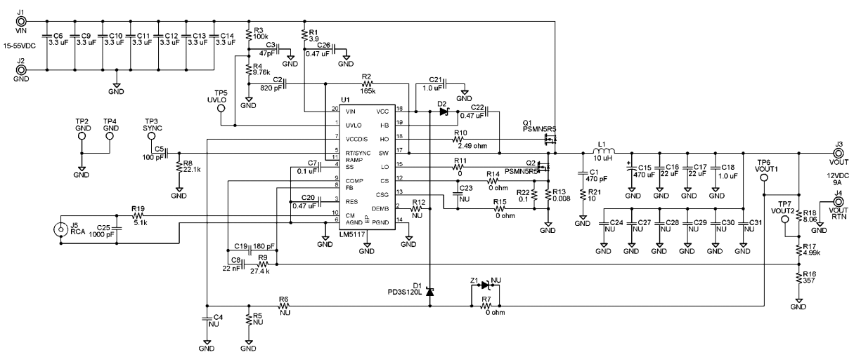

  • Hi Eric,
    I'm using the evaluation board from TI so it's basically the same as theirs except for those components that I've changed:
    C15 - 47uF, 55 mohm
    R3 - 54.9k
    R4 - 2.32k
    R9 - 30k
    C8 - 18nF
    C19 - 56pF
    R8 - 18.7k
    Here is the circuit: (Literature Number: SNVA466A)
    Could you tell me what software are you using to simulate so I could do it on my own?

  • Let me add: there's could be something wrong in your current sense circuit!
    From DS I can see that the current sense threshold is set to 0.12V.
    If you want 2A on your output it is reasonable that your peak current will not exceed 2.5-3A...
    With the resistor you put in your schematic (0.1 Ohm in parallel to a 0.008 Ohm) your threshold is never reached!!!!
    You're trying to work with a current mode control, but you're not controlling current...
    Bye
    Paolo
  • Hi Paolo,
    I'm working at 264.658 kHz (blame webench for the weird number).
    I'm not sure how do find my closed loop crossover frequency and ramp amplitude. Could you point to me on how to get these data? I do not own a network analyser and I only have a 100 MHz scope. Please advise.
    My mistake, I forgot to let you know that I also changed R22 and R13 to a total of 40 mohm.
    WInston

  • Hi Winston.
    First of all, I will try to increase your current sense resistor...
    @264kHz with a 47uH inductance you should have something in the range of 2.5Apeak...
    A 47mOhm resistor has to be considered...
    With your number, I can suggest you this compensation network in order to maintain your 26.4kHz desired crossover frequency:
    R9=8.2kOhm
    C8=330nF
    C19=6.8nF
    Please, try in this way and let me know if something changed...
    Bye
    Paolo
  • Hi Paolo,
    Regarding the current sense resistor, if I increase the value to 47 mohm, my max current limit will decrease meaning there are higher chances the LM5117 will cut off the power during load transient where the current will max momentarily, am I right?
    Thanks for the new compensation values. I will try it once my parts come in. Before that, could you explain to me how did you get it? Did you use the TINA-TI or SwitcherPro to get the value? I would like to know how you get this value so I can calculate on my own.
    Winston
  • Hi Winston.
    If you think that 47 mOhm are too much for your application and you need more margin for your transitions you can think to low it to 39-33mOhm, not more, otherwise your current mode control in uneffective...
    I don't use any particular software to calculate values, I've designed an excel sheet that depending from circuit parameters and oscillator ramp give me as a feedback the open loop crossover frequency, then I only need to choose my desired crossover frequency and all the compensation network data are given me as a feedback...
    Bye
    Paolo
