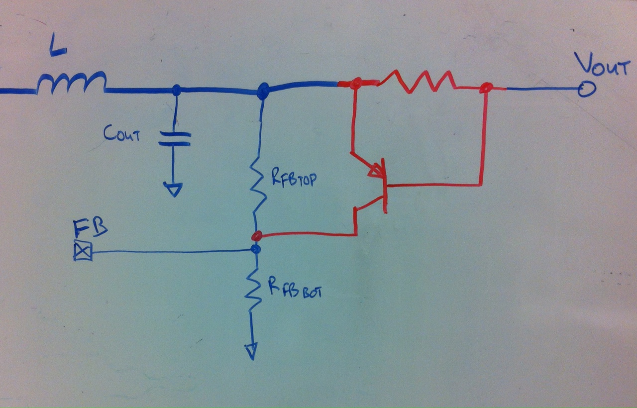

Hi ,
Can any one suggest how to limit the current to 500mA in LMR14206 part, this is for mobile charger application based on 12V lead acid battery and step-down to 5V need to limit the current to 500mA.
Datta
