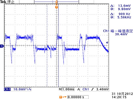

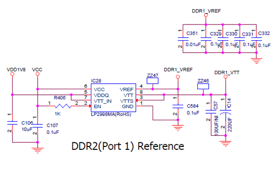

We use LP2998MA for DDRII. The output ripple is about 50mV ( Measure with 20MHz BW ). Th eoutput capacitor is polymer capacitor, 220uF.
I have tried several kind of capacitors, such as ceremic and tan-capacitor.
I am not sure if it is oscillation? or just normal ripple?
If I connect a 10ohm resistor from VTT to ground, the ripple will decrease to 5-10mV. I want to know the reason, and if it will cause other issues.
