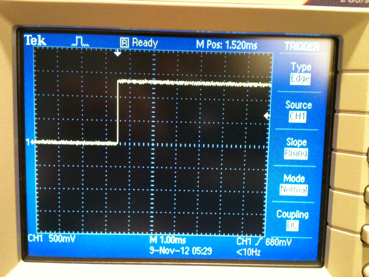

Hi All,
We are seeing a pop noise whenever audio is enabled. We have connected Predriv Left of TPS65950 to 8ohm speaker through Class D TPA2010D1.
When we measured the Predriv.left signal, we could see that there is a DC content for ~90mSec before actual audio comes out. Is something wrong with the register configuration sequence?
Thank you in advance for the reply.
Thanks and regards,
Mahesh Hooli

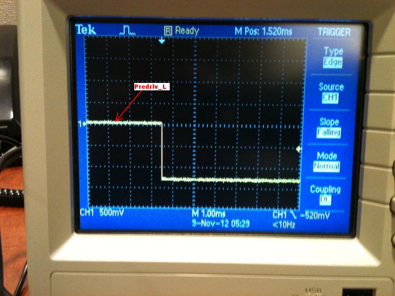

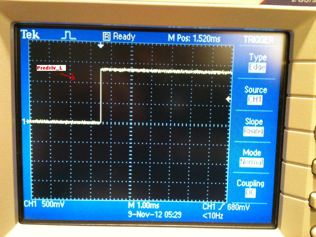

    To debug the above Pop noise issue, we isolated the Predriv_L from Class D amplifier input and probed the Predriv_L line.
    By default the Predriv_L line is low (0V). Whenever I execute command amixer cset name='PreDriv Playback Volume' 3,3, It rises to 1V very sharply and comes down.
    If I disable it by running amixer cset name='PreDriv Playback Volume' 0,3, the Predriv_L line goes to -1V sharply before it comes back to 0V.
    Please find the oscilloscope captures below ( when Predriv is enabled or disabled).
    Do we have to follow any particular sequence in configuring the PMIC registers to avoid this pop up?
