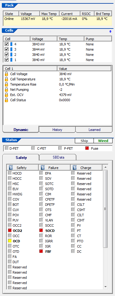

Hi
I am using a BQ78PL114S12 (FW 5000) and a 4S2P Li- Ion battery pack with 4400mAh. I'm still configuring the device. Today I wanted to configure the Hardware Short Circuit Protection. I thought, this would be done quickly, but I was wrong. Although I think, I've set the values for the Hardware Short Circuit Protection, properly it never gets triggered (HSC Flag not set). Instead the 10A slow blow fuse evaporates. For testing I use a 0.68Ohm 17W resistor, because I don't  want to directly short out the battery. When "shorted out" via this resistor, the pack delivers nearly 24A. This current develops a voltage drop of approx. 240mV across the 10mOhm sense resistor. This current is properly displayed in bqWizard. Sure it clips at -20A because of the 10mOhm Sense- Resistor and a gain of 5.
The Hardware Short Circuit registers are configured as follows:
Hardware Short Circuit threshold: 47
that means it should trip minimum at 12.6A and maximum at 16.8A if I'm not wrong?
Hardware Short Circuit recovery: 15
Hardware Short Circuit Time: 3
HSC Max Attempts: 1
So If I short out the battery pack via the 0.68Ohm load resistor, all other overcurrent discarge flags are set (Tier1 Tier2 ) but the HSC isn't triggered.
I don't understand where the problem is. Maybe the hardware shortcircuit detection is dependend from any other registers, although there is nothing written about it in the technical reference manual.
Please help!
Kind regards
Gregor
  • Gregor,
    Are you really using a 680 mohm sense resistor? I am not sure that the device can be configured to work with a sense resistor that large. The thresholds were designed to work with resistors in the 1 to 10 mohm sense resistors.Can you lower the value?
    Tom
  • Oh you've misunderstood me. I am using a 10mOhm sense resistor. I use a 0.68Ohm resistor as a load resistor to simulate a short circuit, without exceeding the battery's discharge current limit which is 25A. In my application I will have max. 6A current continiously flowing. So 12.6A to 16.8A is a good threshold value for short circuit detection in this case.
    Here are my configurations for safety level 1
    The whole configuration can be seen here

  • Gregor,
    Thanks for the clarification and I should have the problem more closely. I have tested HSC before and found it to work, but I did have it not work on one occasion. It turned out to be a calibration problem in that case. I did have a customer problem previously that turned out to be a layout problem. Are your other current faults occurring at the proper thresholds? You can also place a current limited voltage across the sense resistor to test HSC and other current limits. That can be easier and safer than shorting the pack.
    Tom
    That's indeed easier :)
    I've recalibrated the chip. The current measurement should now be better than 1% accurate.
    I've verified, that all the other current faults are occuring properly. As you suggested I've connected a PSU at the sense resistor and tested the circuit at 68mV, 74mV, 100mV and 200mV voltage drop across the sense resistor, which translates to discharge currents of 6.8A, 7.4A, 10A and 20A.
    At 6.8A there were no safety rules triggered.
    At 7.4A the "OC Discharge Tier 1 Threshold" was exceeded and after the "OC Discharge Tier 1 Time" the OCD Flag was set and the Discharge Mosfet was switched off.
    As the "OC Discharge Tier 1 Threshold" value is -7200mA this rule worked just as expected.
    At 10A the "OC Discharge Tier 2 Threshold" was exceeded and after the "OC Discharge Tier 2 Time" the OCD2 Flag was set and the Discharge Mosfet was switched off. The OCD Flag switched to yellow in bqWizard.
    As the "OC Discharge Tier 2 Threshold" value is -9600mA this rule worked just as expected.
    At 20A the HSC detection should kick in, but instead the BQ78PL114 just behaves like at 10A and sets the OCD2 Flag.
    On the attached screenshot you can see the behavior of the Chip @ 20A discharge current. Of course I get a fuse blow failure, because I directly input the sense voltage to the chip, so switching of the Mosfets has no effect on the discharge current, so the BQ78PL114 tries to blow the fuse, which fails.
