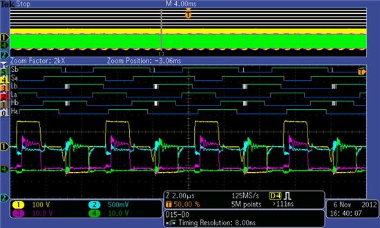

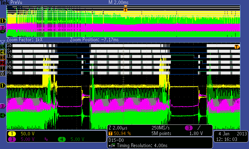

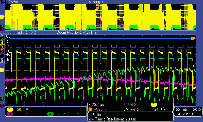

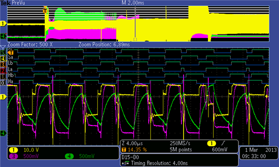

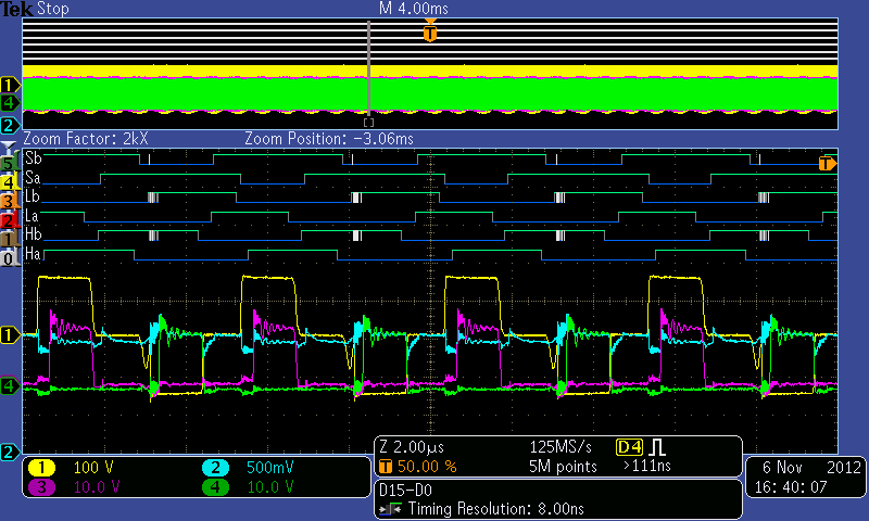

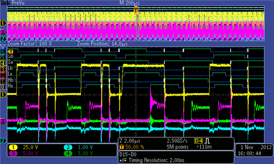

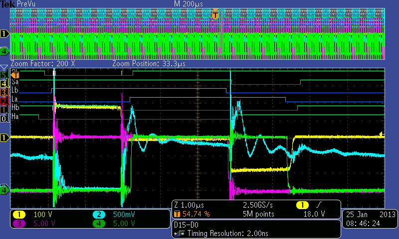

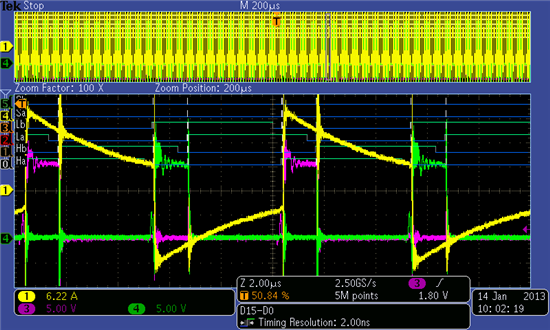

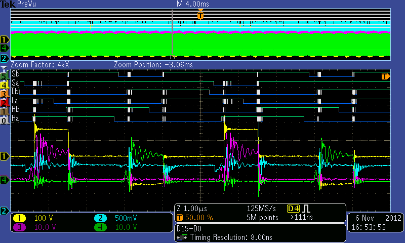

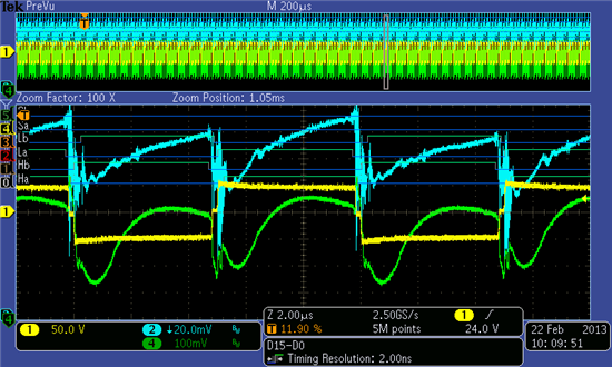

Dear All,

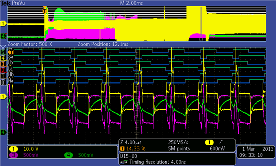

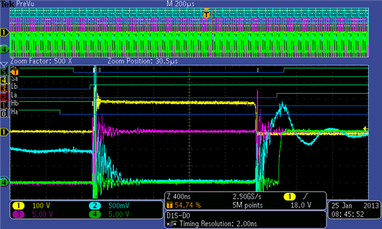

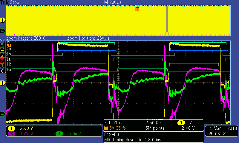

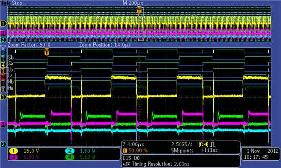

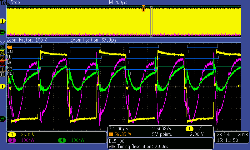

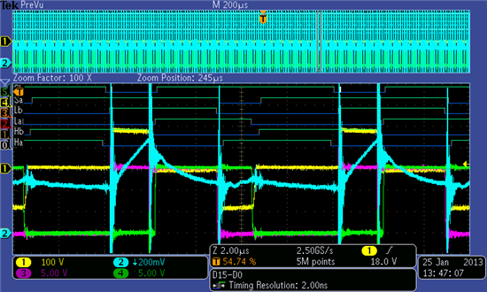

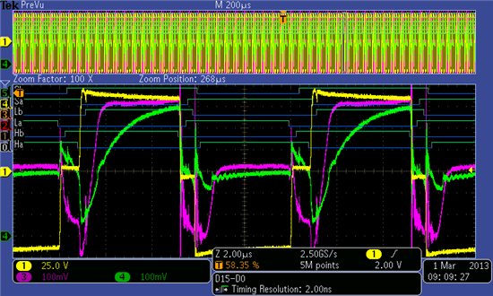

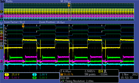

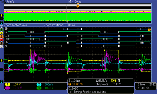

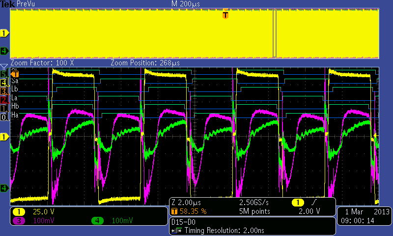

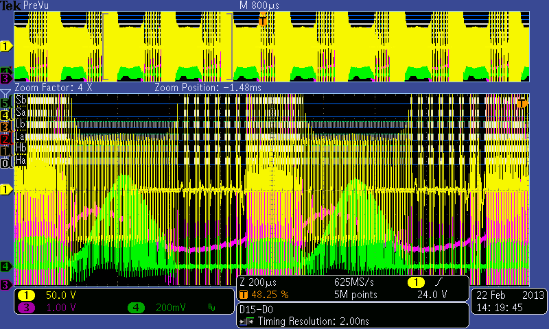

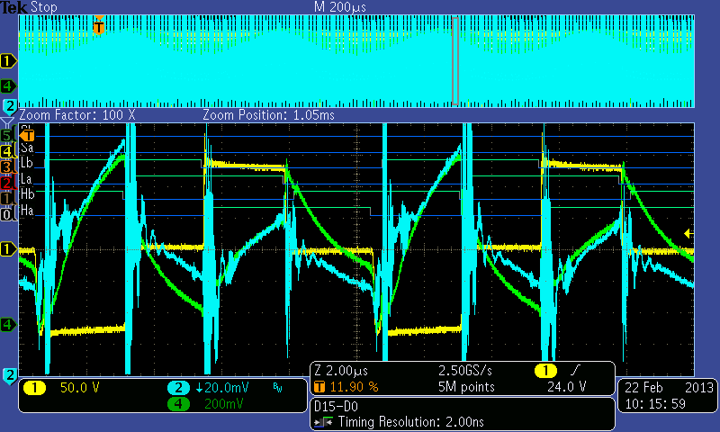

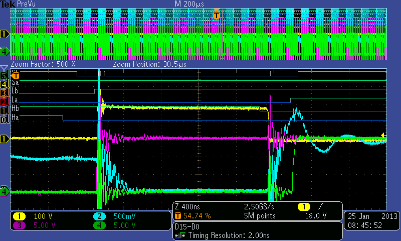

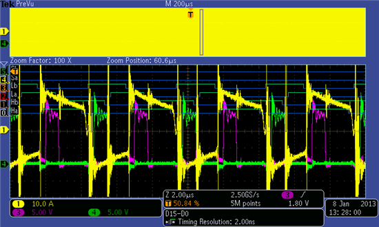

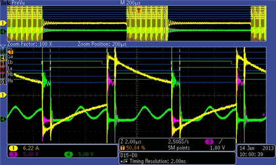

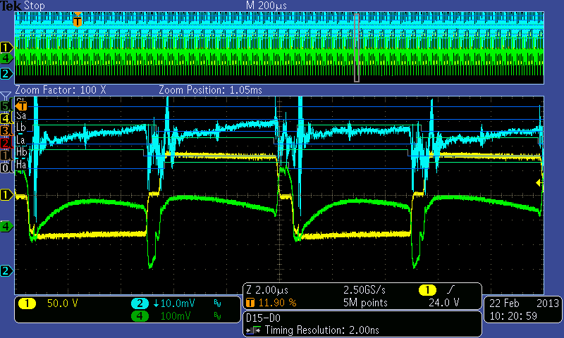

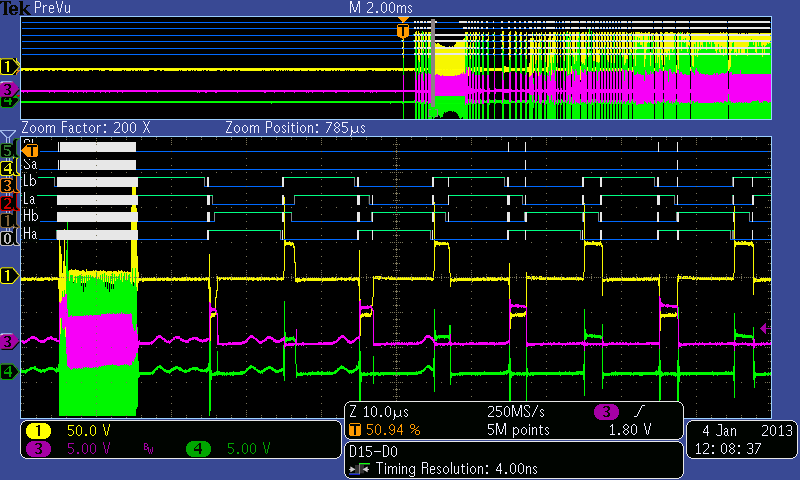

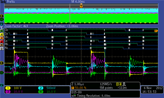

I have problem with my DC-DC SMPS. I am using UCC28950 with i-coupler (ADUM1100) and drivers ADP3630. Final design should be 400 V to 12 V/80 A. I have no trouble with my solution without any load. Signals are correct (app. 50 % duty for each signal), but with load UCC28950 starts to send this strange driving signals. On my scope I watch on output signals of UCC28950. This strange acting starts at condition when output duty cycle starts to fall from maximum. In this situation are one Hi side fet and one low side fet on opposite side getting hot.
Because I had troubles with limitation because of current I have CS pin connected to ground and I have also connected DCM connected to ground.
With shrim:
Picture description:
Channel 1: voltage on one side of bridge
Channel 2: voltage on COMP pin
Channel 3+4: voltage on secondary side fets
Digital inputs are
Ha, Hb: High side FETs driving signal from the UCC28950
La, Lb: Low side FETs driving signal from the UCC28950
Sa, Sb: Secondary side driving signal from the UCC28950
