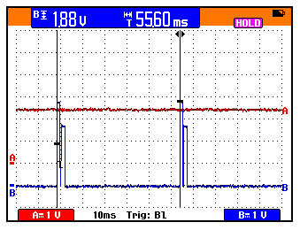

  • Regarding the advanced MPP circuit I have a problem with the clock signal controlling the switches to measure the open circuit voltage and to reload the CREF capacitor, when the Battery is empty or while startup.
    The reason is the clock signal is generated from a microcontroller powered by the battery, so without the battery i don't get a clock signal to load CREF and therefore VIN will always be kept at VREF = 0V.
    An idea was to use the "clock signal" from the VRDIV Pin to control the switches!?
    Is it possible to use this output for driving the switches, especially during startup?

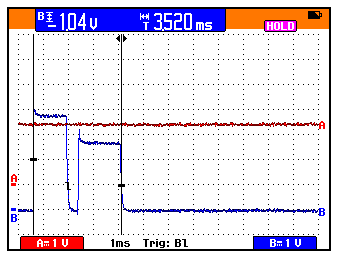

    Another problem is that there are 2 pulses, but i would prefer just to use the first pulse.
    So Ton/Toff would we 55ms/1ms = 55 nearly the same as 16s/256ms = 62,5.
    Any ideas of doing this, with a simple ultra low power circuit, I was thinking of doing it with a monoflop?

  • The timing is fixed and is not user adjustable.  Loading VRDIV is not recommended, unless you add a buffer to isolate any loading.  You could disable the MPPT circuit and apply your own voltage to VREF_SAMP.
