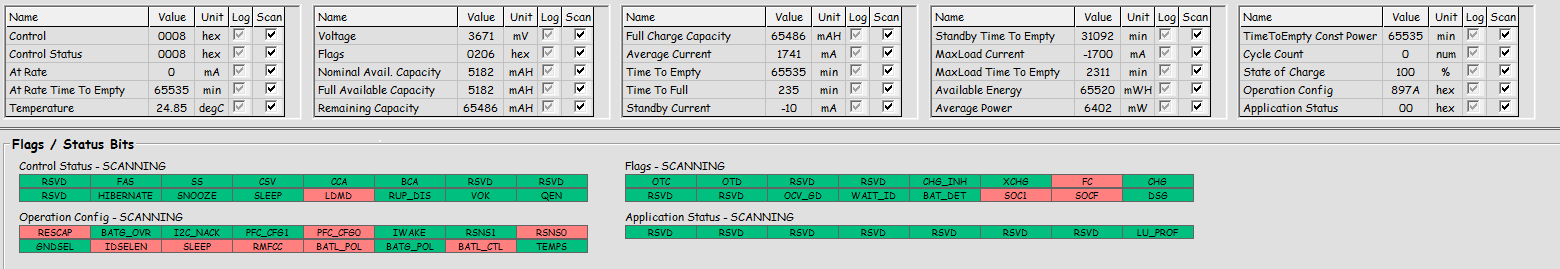

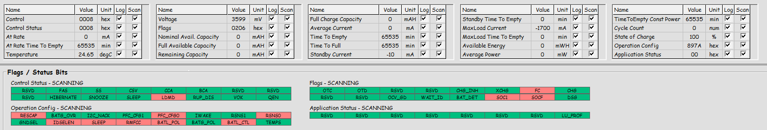

Everything is looking fine, but i never see that the VOK & QEN bit goes to 1 by starting the IT-algorithm.
So the update status goes never to 1 or 2 and Qmax is never updated too.
As a result of that, the learning cycle fails.
But i see, that the fuel gauge is in a state of learning after enabling the IT-algorithm, because after one cycle the reported capacity is very accurate.
I am using a professional li-ion battery charger (cadex C7200).
Discharge current : 1.3 A
Charge current: 1.7 A
I am reaching all voltages and currents I specified in the configuration during charging and discharging (FC & SOC1 & SOCF are correctly driven).
There is no RUP_DIS, no other malfunction, ....
It would be great, if you could help me with finding the problem I have.
Thanks a lot!!!
Here are some screenshots I did:
(Next time I will log all data during the whole cycle)

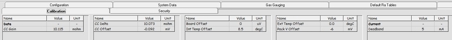

FLASH Calibration:

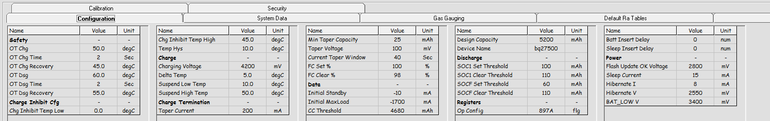

FLASH Configuration:

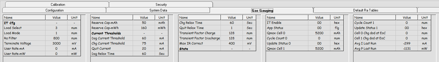

RAM Before Step 1:
FLASH Before Step 1

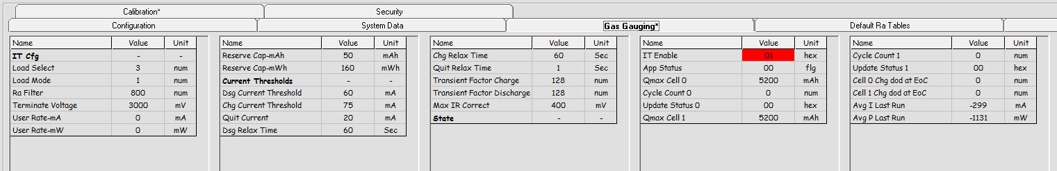

RAM After Step 2:
FLASH After Step 2:
