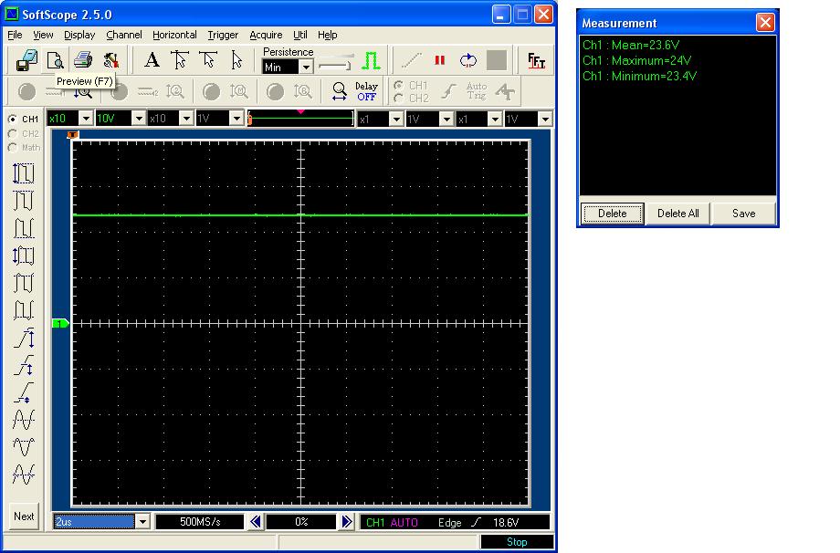

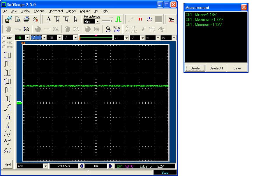

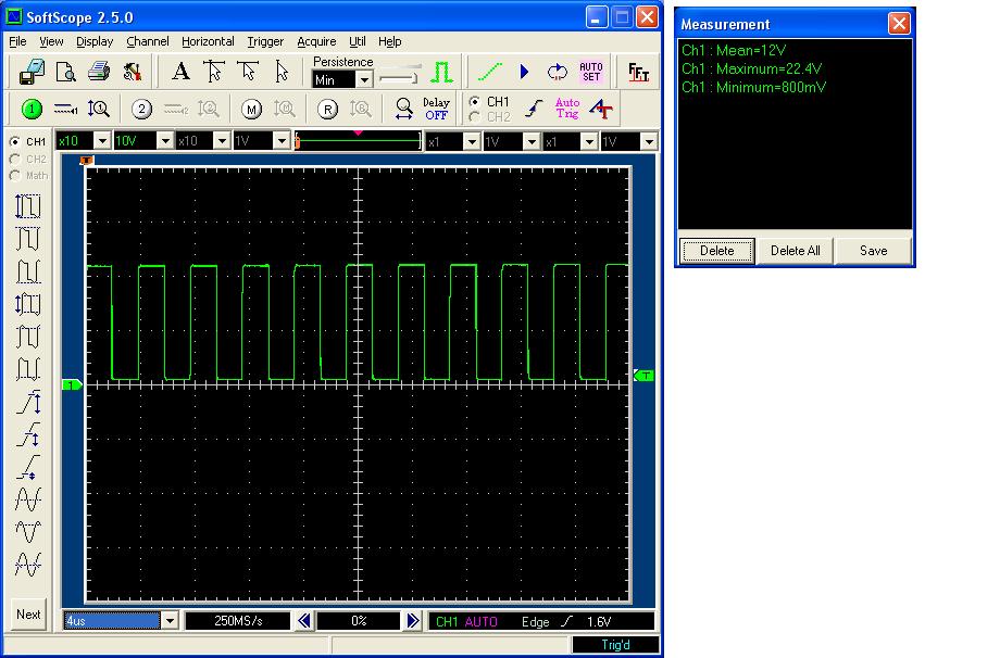

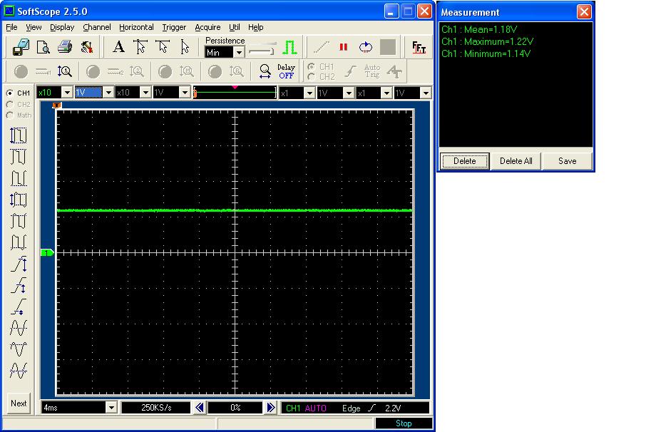

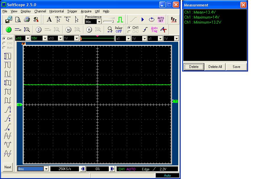

  • I reduced the current limit resistor to 4.7K and tested the circuit. But still the issue remains. I have attached all the plots that you asked for below. As mentioned in my previous mail the current limit increases to the desired value (2.8A) if I reduce the input to about 16-18V. Any idea why this is happening ?
    Switch Pin Output
    Current Limit Pin Voltage
    Voltage Feedback Pin Voltage
    VOUT
    Voltage Input
    Best Regards
    Syam
  • Hi Syam,
    These waveforms are at the good condition when Iout is low. Can you send waveforms at the point when you start seeing unregulated voltage so we can evaluate the switch node.

  • Thanks Ismail. The plots were taken with load connected (about 2A). Voltage doesnt vary at a level more than what was shown on the earlier plots.

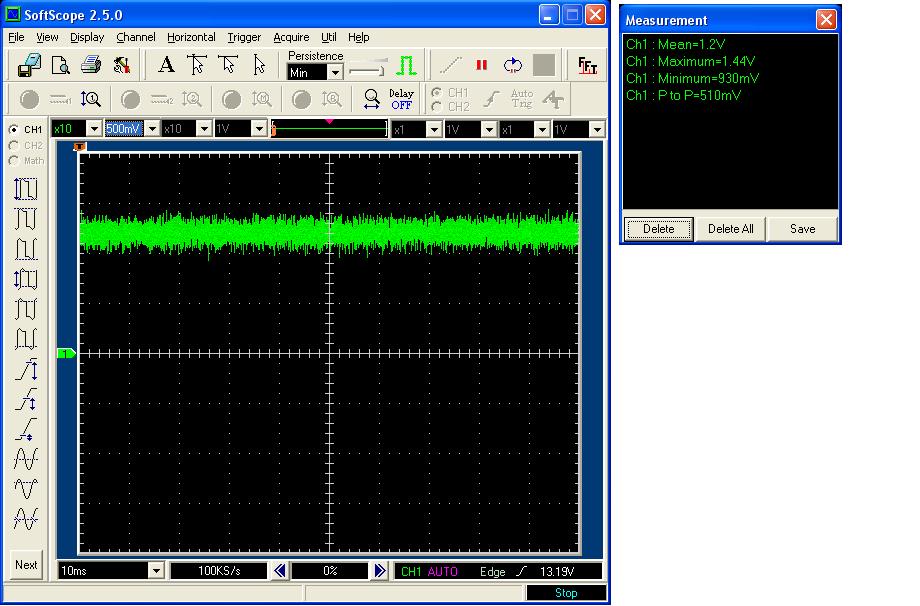

  • Hi Ismail
    Yesterday when I took the plot the oscilloscope bandwidth limit was ON which restricted the bandwidth to 20MHz. I took a new plot of the signal at the current limit pin with bandwidth limit turned off. Please find that below. This is definitely more noisy than seen in the signal plot necessary. Currently am testing the circuit with only one regulator turned ON and with a 1K feedback resistor (about 13.4V output) and 4.7K current limit resistor soldered directly to the GND pin of the regulator to eliminate noise coupled from other regulator circuits. The noise pattern on the current limit pin is same even when the output current goes to 2.8A at reduced input voltages or with all regulators turned ON. So am not sure whether this noise is the problem. Any ideas ?
    Best Regards
    Syam
