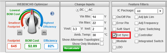

    Apologies for the late response. Yes, synchronization will help. You should choose switchers that accept external sync signal. I would encourage you to use our online design tool WEBENCH (Link). Once you enter the design requirements, the tool will start calculating solutions and you will see a panel like this:
    If you check the Ext Sync box, the tool would suggest only solutions that fit the input and output voltage requirements AND also have the feature to be synchronized to external clock.
    I hope this helps.
