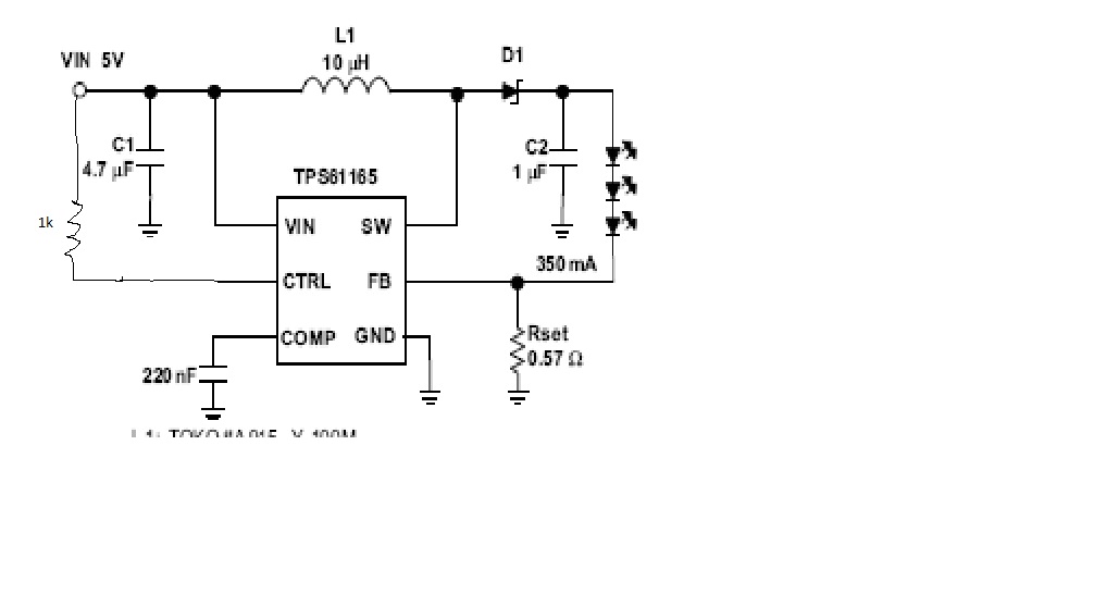

Dear all
i'm going to done a dc dc driver using TPS61165
Vin-3 to 5V dc
Vout- 12V
Iout - 350mA
But, when i connect the supply 3V or 5V the output is just only 5V. and the curent is not controlled, it varies from 3V input to 5V input dc. Here me attached my circuit with component values.
