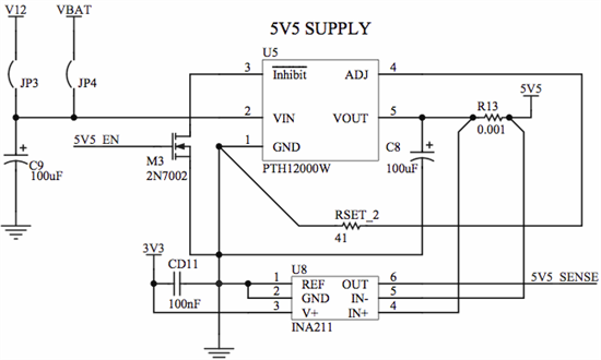

I designed a PCB that uses a PTH12000WAH to regulate 12V input to 5V output voltage. When the unit is powered on, the PTH12000WAH module sinks permanently 150mA when a load is either connected or not. I used those capacitors : EEE-1CA101WP
I changed the module with another one and the problem is always there.
It is possible that my input capacitor would cause this problem? I checked my PCB circuit many time and no problem has been found.
Note: on the schematic, you can see 5V5, but it should be written 5V and the RSET resistor should be 280Ω
