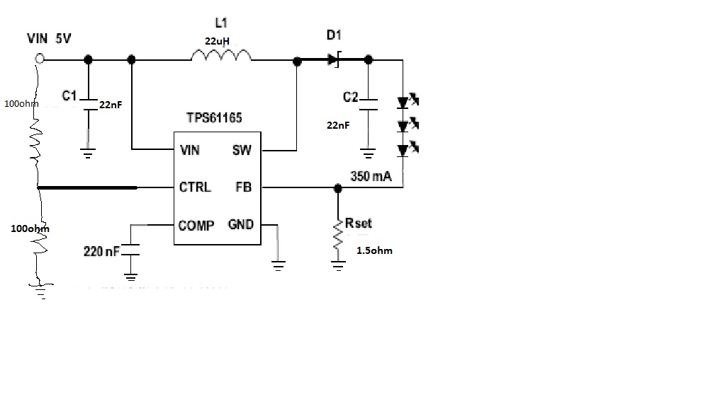

Dear all
i'm going to done a dc dc led driver using TPS61165
Vin-3 to 3.7V dc
Vout- 12V
Iout - 350mA
When i connected the supply the output is just only 6 V and the current is 240mA. As per the calculation the current is 350mA. (VFB=IOUT*REST). how can i achieve 350mA out put current.
If i change the input filter or the output filter, the output is getting low.now the Cin=22nF and Cout=22nF. The current sense is 1.5ohm. inductor value is 22uH.
