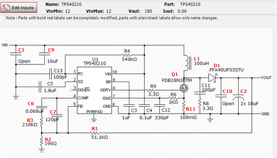

I've built a boost converter, 12V->180V, using TPS40210. I am trying to replace a design based on a MAX1771.
The new design works, and at a first glance behaves great: low ripple, no significant noise anywhere in the circuit, behaves nicely under load. Problem is, the efficiency is only 45% at 13 mA load! I expected to get at least to 75%, which is what the similar circuit using the Maxim part gets.
I expected to be able to get up to 85mA @ 180V from this circuit. The (shielded) 100uH inductor has a peak current of 2.4A (the inductor is MCSDRH125B series from Multicomp). The MOSFET is an IRFH5025, with RdsON=84mOhm, Qg=37nC, Qgs=8.3nC.
The losses seem to be incurred in the inductor, as this is the part that gets hot after a short time. Now, I'm puzzled, because I'm comparing this board to one just next to it: the other one is based on MAX1771, uses the same inductor and an IRF644, which has much worse parameters (RdsON=280mOhm, Qg=68nC, Qgs=11nC). And in spite of many problems (noise in the feedback circuit, ringing, etc) has no problems reaching 75% efficiency with the exact same load. The inductor doesn't even get warm. So why does it get hot on the TPS40210 board?
I am posting the relevant part of the schematic and the switcherpro output, which this design is based on (please ignore the double inductor, it is there only to provide pads/vias for both SMD and THT inductors). I can also post pictures of the PCB design and the assembled circuit itself.
Also, I'm attaching a picture of the gate signal of the MOSFET, taken with a 10x probe. I find the duty cycle highly suspicious.

  • Hi Jan,
    Looking at the gate drive screenshot makes me think it might be unstable. Can you modify up the SwitcherPro design to match your circuit to check the loop stability? Main components to change being the inductor, current sense resistor, output capacitor, fb resistors and compensation components.
    Anthony
  • Ok, I did my best to try and exactly reproduce my components in SwitcherPro. This is the loop response graph I get:
    It seems that the choice of output capacitor (C10/C2) has a huge influence? That is not something I expected or knew about.
    In the meantime I also discovered that I mistakenly placed two 0R100 resistors in parallel as Rsense, instead of just one. The two resistors in my schematic are only to provide an easy way to build Rsense with smaller power rating parts. After removing one (which leaves Rsense as 0R100) the situation does not change. If anything, the inductor gets hot even faster.
  • Hi Jan,
    The output capacitor does have a big influence on the control loop. The output capacitor and the load current decide the Dominant Pole Frequency which is 1.1kHz in the SwitcherPro screenshot you gave. Based on this your compensation looks fine.
    You might be running into the maximum duty cycle limitation of the TPS40210 with this conversion ratio based on the minimum off time. Not including any efficiency losses for the real duty cycle the calculated off time is 222ns. If you assume 80% efficiency the off time drops to 178ns.
    One thing you cant try is to decrease the switching frequency from 300kHz to 50kHz to see if there is any improvement. This will increase the off-time. After doing this you will also need to decrease Rsense for the higher peak currents so you don't trip the ocp.
    Anthony

  • This is the layout I have (any feedback is appreciated). I don't see how I can make the gate trace much shorter. My main goal in this layout was to keep the high-current loops away from the low-voltage part of the feedback circuit.
    As for mass production, no, this is a hobby project, but it isn't a one-off either -- I do expect people will build this design, which is why I'm spending quite a bit of time on it. I will test the behavior at various frequencies again, then.
    Many thanks for your help on this so far.
  • Hi Jan,
    Another suggestion I have is to replace the gate drive resistor R9 with a 0 ohm resistor. Reducing this can increase the slew rate of the gate drive signal to help turn on the FET as fast as possible for operating at the higher duty cycles.
    Looking over the layout it looks good. Ideally I would try to have the ground of the output capacitor C11 right next to the ground of the current sense resistors while keeping the VOUT side of the output capacitor close to the diode. But with the high voltage design you become limited by the components you can select and the snubber is in the way.
    I didn't look closely at it before but it looks like C8, C2, D2, and D3 are used to create a charge pump? What is this used for?
    Anthony

  • Anthony,
    Here's what my gate drive looks like. The bottom trace is a magnified part of the top one. As you can see, it takes about 100ns for the voltage to ramp up. That's with a 10x probe loading the gate.
    Are you sure I should try a gate driver circuit? It isn't easy to prototype, so I'd rather not, unless we're certain this is the right direction. The gate drive looks reasonable to me.
    I've done some thinking and looked at the triple screenshot I posted last time. I think my stability problems begin as the circuit transitions from DCM to CCM. I also took the liberty of doing a quick plot of the transition boundaries in my circuit, for various values of L in uH (this is based on the simplified equation (4) from page 12 of the datasheet):
    I'm testing the circuit with 53.5mA load, so it looks to me that I'm hitting the DCM/CCM boundary right around 11V, which is consistent with what I'm seeing.
    Given the high step-up and the wide range of output current, I don't think I can avoid the DCM/CCM transition.
    Now, I can't really show you how the traces "look" like when the circuit is unstable, because I can't really see them with my analog scope. It looks as if the peak voltages remain the same all over the circuit, but the duty cycle alternates between multiple values. No matter how I try, I can't get a stable trace.
    Isn't this related to sub-harmonic instability described on pages 15/16 of the datasheet? "alternating long and short pulses from the pulse width modulator" would be consistent with what I'm seeing (or not seeing) on the scope. Problem is, much as I try, I can't understand that section (BTW, Acs isn't defined anywhere, and m2 is defined, but not used). It also doesn't help that Risns(max) for my circuit is about 6mOhms, which isn't practical.
  • Jan,
    Good thinking and this is a very useful plot.
    From your description I think you're right with the subharmonic instability in CCM if your RSENSE is too large. I had not gone through these calculations to check your maximum value of RSENSE previously. Also when I looked at your 3 images to me it looked like you were at the DCM/CCM boundary too so it makes sense.
    To get around this is it ok for your design to operate in DCM the whole way? If so can you try reducing the inductance to see if you can get more output current? This will force you to stay in DCM and here you will completely avoid issues with subharmonic instability. When operating in DCM the current feedback path does influence the control loop. But you will need to make sure your OCP level is high enough to accommodate the higher peak current.
    Alternatively if you need to use 100uH and you want CCM you can try to reduce your current sense resistor further or divide the current sense signal down as suggested on page 16 of the datasheet. But this will also increase your peak current limit level.
    Lastly Acs is up in the electrical specifications table on page 4. This is the gain of the current sense amplifier. Sub-harmonic instability is something inherent to current mode control with duty cycles greater than 50%. A compensating ramp with a down slope (m2) must be added to the current ramp before it goes to the PWM logic to avoid instability. There are quite a few articles on it. Let me know where you're confused and I might be able to help you understand if you're interested.
    Anthony
  • Thanks! I intend to try both approaches:
    a) A smaller inductor. Operating in DCM is not a problem at all. But another quick plot shows that in order to support the maximum of 220V (which I'd like to be able to get to), I'd need to go down to 47uH. At 68uH I can't guarantee DCM operation at 11V Vin and 60mA/220V output. I haven't done the calculations yet, but I'm worried about peak currents.
    b) I'd really like to understand and implement slope compensation, but I don't feel comfortable taking up your time for something I can read myself. Thing is, much as I try to understand it, the section on subharmonic instability in the datasheet still does not make much sense to me. The referenced SLUA101 does explain the *problem* very well, but doesn't get me any closer to a solution. And most literature available online either explains the problem, or explains how to build slope compensation from a feedback or oscillator signal, which is not what I should be doing with the TPS40210.
    From what I understood, the TPS40210 has internal slope compensation. This means that my job as a designer is to provide a properly scaled signal at the ISNS pin, so that after passing through the current sense amplifier it "matches" the slope compensation signal generated inside from the oscillator. The current sense amplifier has a gain of roughly 6. Now, what I can't grasp is why the voltage compensating ramp slope is discussed if I have no influence over it. I guess I'd expect a "desired peak voltage for the ISNS signal", so that I can use a resistor divider to scale whatever I get from my (overly large) Risns. The datasheet hints at this kind of solution (last sentence in the section), but that hint is not enough for me :-(
    Am I way off? Please feel free to just point me to additional reading or just ignore this part.
  • Hi Jan,
    All this information is great. You've really helped to analyze using the TPS40210 in an application like this. Unless I've done my math incorrectly, with a 47µH inductor the peak current is only about 3.75A. I've attached the excel with my calculations with the below link.
    1172.TPS40210 220V Boost.xlsx
    Your understanding in b looks correct. The slope compensation is fixed and you have no influence. This equation is mostly to ensure the slope compensation is sufficient for the sense resistor selected in your design. It is discussed to help give some understanding of why this limitation is placed on the sense resistor. The slope of the actual internal ramp is given by Equation 8.
    Anthony
  • I redid the calculations and 68µH should leave enough margin to stay in DCM. Verified experimentally -- things work just fine with both 47µH and 68µH inductors. No unstable behavior anywhere in DCM, though I still have to build a circuit to test the transient response.
    Ok. So my sense resistor is 50mΩ. The maximum calculated value to avoid instability is 3mΩ. Two questions:
    1. Am I right in thinking that by using the maximum acceptable value I basically give up overcurrent protection, and there is nothing that can be done about it?
    2. Instead of using a smaller Rsense, can I add a resistor across C12, thus forming a divider which would scale Vsense down?
  • Hi Jan,
    Good to see the lower inductor values worked well.
    Correct if you were to use 3mΩ the over current protection limit will be a very high current and won't provide much protection. However, when planning to operate in DCM for all conditions you do not have to follow this equation. When operating in DCM the slope compensation has no impact on the control loop. In this case the control loop operates more like voltage mode control. Instead the resistor can be set for over current protection only. But supply will most likely be unstable if it begins operating in CCM.
    Yes this works but will be equivalent to using a smaller resistance Rsense.
    Anthony
