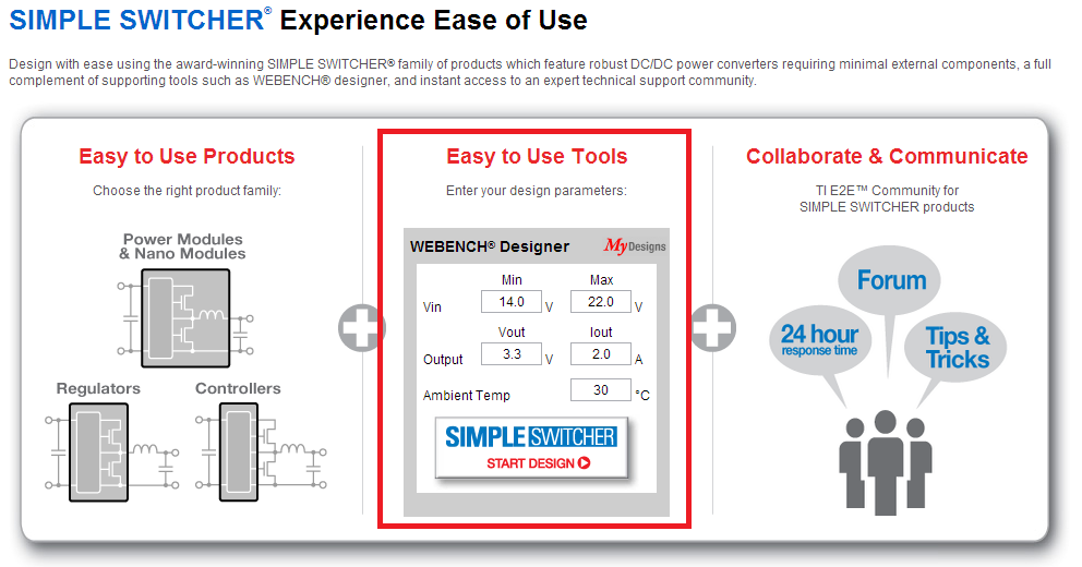

    I would suggest using WEBENCH (our online design tool) to select an appropriate converter. Go to http://www.ti.com/ww/en/simple_switcher_dc_dc_converters/index.html
    You will see a page like this:
    Enter your design requirements in the WEBENCH Designer panel and click on Start Design.
