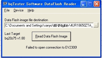

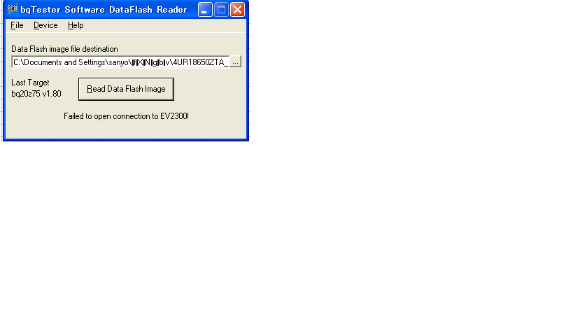

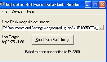

On ROM Imager, Last target changes. Is this phenomenon normal?
1, Run bq Tester ROM Imager
2, Set target "bq20z75 v1.80"
3, Push "Read Data Flash Image" button
4, Last Target name changes during ROM file is created.
5, ROM file is created.
From the screenshot it is obvious that the program is not able to open a connection to EV2300. Any operations performed when the EV2300 connection is not opened are invalid.
The answer to the original question is that the last target could change if the actual readback was from a different target/version. Please check if the last image read was from a EVM with a different version of firmware.
