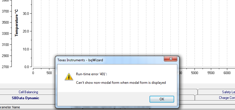

I'll attach the screenshots I took today of the crash. Both crashes were identical; they occurred when I tried to load the pack configuration onto the BQ on the newly-built boards.

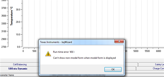

The crash (keep in mind this happened twice on two different boards).
(I have no idea what modal form the message refers to; as far as I can tell no other dialog
was open and I took particular care the second time around to ensure nothing was amiss).
This is what it says when I click 'ok' after the run-time error.

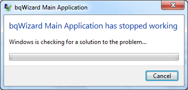

When I click 'ok' again, I get the 'bqWizard has stopped working' message.

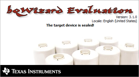

When I re-start bqWizard, the device is sealed. Time to schedule the board for re-work. Thanks TI!

    Connect board, start bqWizard, it happily detects device at address 0x16, loads and sits ready for me to do something. It's a new board so the first step is to load the pack configuration onto the device (this is the same configuration I have successfully used with the dev board). During the process of loading the configuration (after about 5 or 10 seconds) the error dialog appears and the device is hosed.
    That's all there is to it.
    The earlier post indicated that there had been a software crash
    Yes, a crash in bqWizard, just like this one. It also occurred during loading of pack configuration and destroyed the device on the dev board (I later replaced it and it worked without problem after that). This time I decided to take screenshots since I was pretty annoyed.
