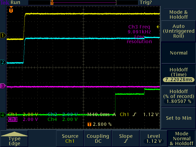

The WDI pin is clearly unconnected on the TPS3823 yet the watchdog reset is happening at the watchdog timeout period.
What is going on?

We have not seen this issue to date. The device may be damaged and the device should probably be switched out. If this is does not work, please attach a schematic and waveforms of VDD, WDI, RESET, and MR. There may be transients that could be violating the operating conditions described in the datasheet.
Darwin
It will only let me upload 1 file, how can I send you multiple files with schematic and O-Scope traces?

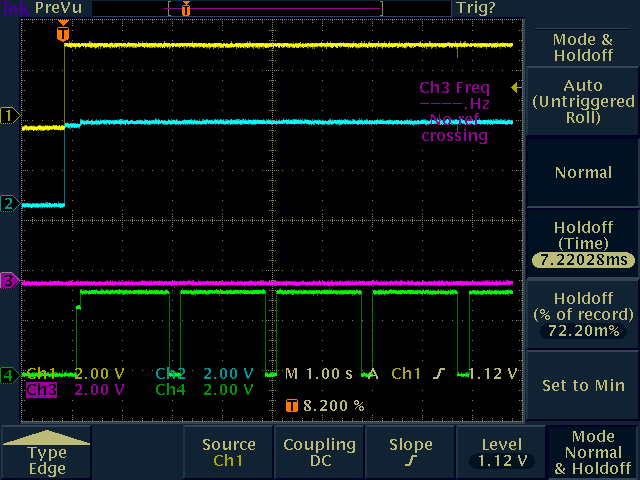

All 3 scope traces were taken from power-off to power on triggering on VDD with different time scales.
You can see the RESET pin humming along in the 3rd trace.

I was not able to replicate this in lab given your application's circuit and it should not behave this way when the WDI is floating. You may need to talk to your local TI AFA and recieve new samples and possibly begin the FA process.

Did you see anything amiss in the screen shots?
I'm wondering why the WDI pin is sitting at ground potential. Doesn't it have an internal pull-up and an auto WD resetting circuit, so should we be seeing some activity on it?
Hi Frank,
I did not see any issues with the scope shots you attached other than the RESET triggering while the WDI is floating.
Checking the WDI pin through an oscope while having it float also showed no (internal) oscilliations. The datasheet's block diagram is very simplified so it can't always be interpretted exactly as shown.
