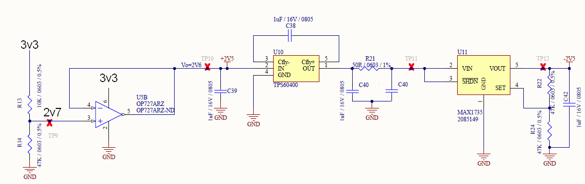

Hi all,
I have the following circuit in order to get a negative voltage of -2v5 from 3v3.
When it start up ok, the circuit is fine, but the question is that it does not startup often.
When I have a failed startup I get 1V5 at C39.
Can anyone give me a tip?
