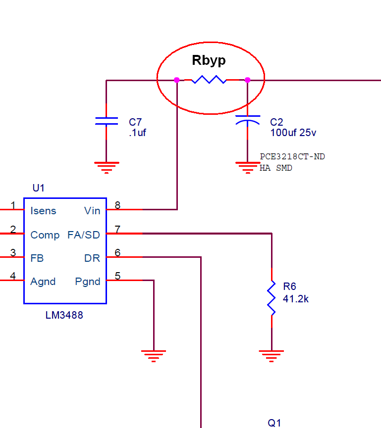

I have an LM3488 SPEC design that will not work correctly below apx. 32F.  It is rated to -40F.  I have re-evaluated the design with WEBench, and it still appears that the internal referance is drifting.  Normal load is 1.25A normal Vout is 12.5v, input is 9 to 15v.

  • In the previous post I made on this problem, which has now been moved to this post(why?), I posted scope pictures of what was happening.  I will try and explain it.  Sweeping the ambient temperature and monitoring the drain of the FET you can see the device becoming more discontinuous as the temperature gets lower.  Like it is trying to regulate at a lower V point.  Once the temperature gets low enough the output V starts to drop as one would expect due to being discontinuous.  This looks more like the devices internal references are drifting and regulating at a lower voltage point.  If I try and start the unit under nominal load below about 32F, it will start running but the output V will be reduced.  The colder it is the greater this effect seems to be.  Yet If I start it with a greatly reduced load or no load it will come up with close to the normal voltage point but sage when a load is applied.  This leads me to believe the internal reference for the current sense is at fault.  I designed this for a customer that wants to use this in an automotive application and needs at least -20F operating range.  If I can not get an answer on this soon I will have to abandon this design , maybe I will look at Linear's stuff.
    I have went back and re-designed this useing TI's WEBench and found that I can improve this problem , but NOT cure it.  Is this desgn faultly or is there a silicon problem?

  • Hello Darell,
    we built your schematic on one of our built it boards and the circuit works fine.
    I took a look at your schematic and layout and I have some suggestions:
    1. make sure the power supply has enough current capabilty.
    2. Please introduce a 100 ohm bypass resistor like in the following image:
    3.The most important layout rule is to keep the AC current loops as small as possible. In a SEPIC regulator the primary switching loop consists of the output capacitor, diode, SEPIC capacitor, MOSFET and sensing resistor. Minimizing the area of this loop reduces the stray inductances and minimizes noise and possible erratic operation. On your layout i can see that the switching current goes from the top layer to the bottom layer throug vias and that's a very bad practice. I suggest you to put all the power component on one layer and make a tight AC current loop.
    4.The current sensing circuit in current mode devices can be easily effected by switching noise. This noise can cause duty cycle jitter which leads to increased spectral noise. The sensing resistor should be connected to the ISEN pin with a separate trace made as short as possible. Route this trace away from the inductor and the switch node. For the voltage loop, keep the feedback resistors close to the IC and run a trace as close as possible to the positive side of the output capacitor. As with the ISEN line, the FB line should be routed away from the inductor and the switch node. These measures minimize the length of high impedance lines and reduce noise pickup.

    Like I previously wrote the circuit works well on bench and we can eventually ship out the board. Anyway i really suggest you to use the LM3481 instead of the LM3488 and to use webench for design a proper schematic.

  • Thank you for the reply.  I assume you did your testing at low temperatures since this was the condition that caused the problem, if not please let me know this?  Webench does not specify added decoupling but I can see the benefit.  As far as the layout is concerned, The cost considerations for this design drove it to a 2 layer design.  But also convincing the layout guys ( who think they know everything) that a better ground plane is needed is always a task.  Marry Christmas.
  • Interestingly enough I tried this configuration and all it did was cause the controller IC to not regulate properly and then the FET & controller self destructed.  From your previous comments I take them to mean the LM3488 is not a viable design.

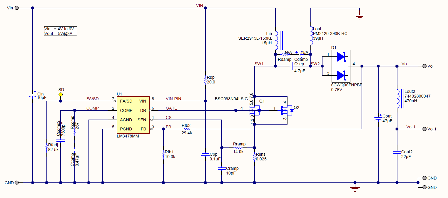

  • Hello Darrell,
    i am sending you the gerbers and the schematic related to a "built it" board we used to test the SEPIC converter.
    A "built it" board is a particular PCB that allows to use different footprints therefore the schematic may look strange.
    Q1 and Q2 are just a DPAK package a PowerPAK package one on top of the other also there is a second stage filter footprints and all the small.
    Giuseppe

  • Not sure how you can claim this circuit properly represents the design I need.  My input needs to be 9 to 15v with a max load of 2amps at 12.5v.  The V in of this circuit is a much smaller range.
  • Hello Darell,
    that is the circuit related to the "built it" board which is a generic board that you can stuff with the components you need.
    That board can support different footprints therefore that schematic is only meant to indicates the designators (components' name) and nothing else, it has nothing to do with your design.
    Giuseppe
