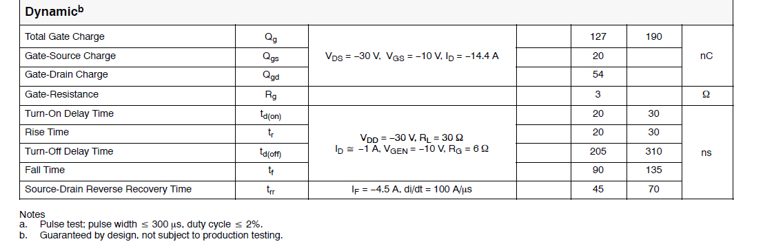

I have this application of dynamically adjustable output voltage with the following specs:
- Vout=16 to 32V, Vin_min=34.155, Vin_nom=34.5, Vin_max=34.845, Iout_max=3.3A, Iout_min=50mA
- minimum ripple voltage
I selected LM25085. I downloaded the Excel calculator and I also formulated my own Excel based on the formulas given in the Datasheet. To validate my Excel, I used the application example in the datasheet (Vin=7 to 42V, Vout=5V, time delay PFET=57ns, etc...) I plugged in the values and both Excel outputted the same Rt=90.9K as expected.
But when I now calculate the L1, there are now disparities in computed values. The example given expects L1=13.5uH which is the same as my own excel outputted, but the Quick Excel Calculator is outputting a different value which is L1=16.2uH minimum. I then tried to just vary the Iout_max and the L1 value also varies. This is unexpected because based on L1 formula (eq.18), it is only dependent on Ton_min, Vin_max, Vout and Iout_min. Am I missing something here?
I went ahead with my computation using my Excel formula and results below:
Vout=16 to 32V, Vin_min=34.155, Vin_nom=34.5, Vin_max=34.845, Iout_max=3.3A, Iout_min=50mA, PFET delay=290ns, Fs=500KHz
Rt=342.8K
Ton_min=1.544uS @ PGATE
Ton_min=1.83uS @SW Node
Then at Vout_min=16V (same Rt), Fs=250.67KHz
Finally, L1 = 52uH @ 32V
              L1=345.7uH @ 16V
Using Quick Calculator, L1=7.9uH! @ 32V

    Do you really have a PFET with 290ns delay?
  • hello Vijay,
    yes, please have a look at SI7461. I have used this since this is already in our material system.

  • Hi Vijay,
    I'm surprised you were able to get 7.9uH using your formula. I proof-checked my formula by inputting the values from the example in the datasheet and got the correct value as detailed below;
    LM25085 Example per datasheet:
    Given:Vout=5V, Vin=7V to 42V, Iout_max=5A, Iout_min=600mA, Fs=300khz, Vos=5mV p-p, tdelay=57ns
    My generated excel sheet yielded the same values for all the external components. For example, in computing L1,
    ton_min=438nS @SW node
    Vin_max=42V
    Vout=5V
    Ior_max=2*Iout_min=1.2A
    Formulae for L1=(ton_min * (Vin_max-Vout))/Ior_max. Using my formula, the output is 13.5uH which is the same with the example. Now, using the same formula with the following inputs for my application;
    ton_min=1.83uS @SW
    Vin_max=34.845V
    Vout=32V
    Ior_max=0.05*2=0.1A
    these values gives me, L1=(34.845V-32V)*(1.83uS/0.1A) = 52.2uH!
    So how did we differ on these values?
  • Hi Romulo,
    Ior_max values are different in your and my calculations. I used Ior_max~20%*IOUT_max.
    It really depends on how much current ripple your are comfortable with.
    Vijay
