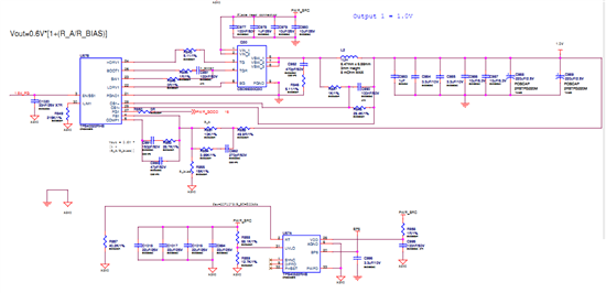

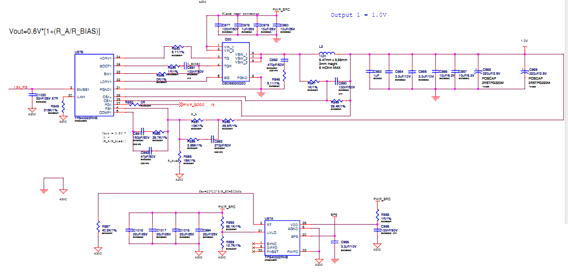

I am using the TPS40322.  The schematic is shown below.

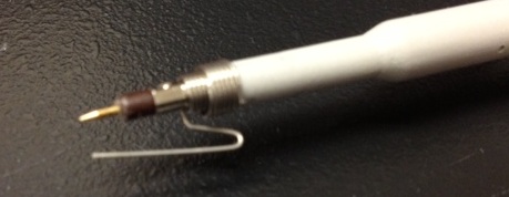

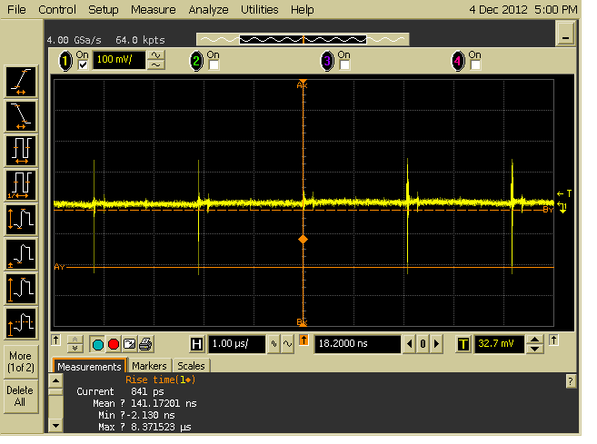

I measured the ripple current on the 1.0V output 220U POSCAP and the ripple looks quite high.  Not sure if it is a measurement problem or if it is a real problem.  Functionally, my product is working in both high/low voltage and in both high/low temperature.   I used the scope probe with a very small ground loop already.
What do you think?
