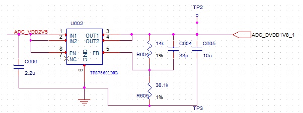

I am using TPS78601DRB to power two LTC2158 ADC. The input is 2.5V and output is 1.8V.
The output is connected to the ADC through ferrite beads. When the ferrite beads are on, the output is 1.71V, and the voltage of FB pin is about 1.17V, not 1.2246V as in the datasheet. When the beads are removed, the output is zero.
I use the right E96 14k and 30.1k resisters right as told in the datasheet.
I have two modules with the same problem, except the output is not 1.71, but definitely not 1.8V.
What might be the problem?

  • This is the schematic, which is the same as that in the datasheet.
  • Hi Xiang,
    It might be good to look at input and output voltage waveforms during startup with and without ferrite beads. It may be that the IC is getting damaged. It will also be good to test this without the ADC load connected first as it might be the load thats dropping the voltage.
    Darwin

  • Hi Xiang,
    I apologize I did not catch this sooner. The minimum input voltage of the TPS78601 is 2.7V. You must increase your input voltage from 2.5V to at least 2.7V to properly bias the internal circuitry of the LDO.
    Please let us know if this helps.
