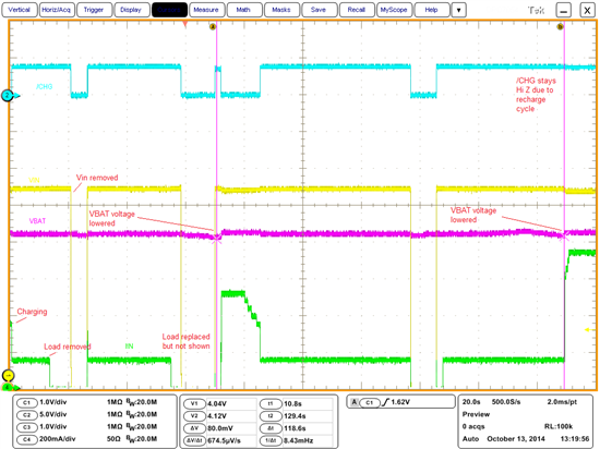

  • Below is a scope plot with the bq24278 EVM tied to a 20 ohm load, 5VIN and a sourcemeter simulating a battery.
    When I repeat your steps above, I see the /CHG pin properly change stage.  If the battery reaches full charge and then bleeds off and enters a recharge cycle (within VIN being removed and replaced in between), the /CHG does not change state because it is designed not to change state for recharge cycles.

    Just to make sure I understand the picture.  Yellow is Voltage applied to IN pin.  what is the green label? Is the charge voltage or current?
    1) 1st low pulse on CHG - Why does CHG go LO-Z for the duration Vin is removed?
    2) 2nd and 3rd low pulses on CHG - Again CHG goes lo-z when IN voltage is removed why (2nd pulse)?  I understand the 3rd CHG pulse as it seems like we are doing some charging for a short time.
    I fully understand the CHG does not go lo-z while re-charging but the problem I am trying to explain is different.
    The case I am explaining (not necessarily repeatable every time) is this.  You fully charge the battery and CHG goes HI-Z.  Then you remove source on IN pin and apply again.  The CHG pin remains LO-Z forever and the current into IN pin is almost 0.  This is sort of what the thread starter also saw but in my case the CHG get stuck in lo-z
    It happens that I saw this condition where I had a load running while I left the charging voltage running over night.  The charger indicated fully charged in the morning (CHG Hi-Z).  Then I disconnected and reconnect the voltage source at IN pin and CHG pin went to LO-Z and stayed there indefinitely.  I have also seen this very exact behavior when I have FULLY charged the battery with another CC/CV LI-PO charger and then connected to BQ24278 charger.  I see almost 0 charge current and CHG stuck at LO-Z.  Another time was when I fully charged the battery and then attempted to charge (top off) a couple of more times but removing the source at IN and re-applying.
    The only way out of this is to drain the battery for even a short time via load and then try a charge cycle.  It seems like maybe there is a case where when the battery is fully charged (or maybe if OC BAT voltage a bit too high) the charger thinks it needs more charging (CHG goes lo-z) but there is actually no charge current provided.  This always happens when the battery is fully charged first.
    thanks, Sadry
  • Yellow is V(IN).  Green is input current into V(IN).
    1.  On the EVM, /CHG is pulled up to DRV.  DRV goes away when V(IN) is removed.
    2.  Same as above.
    To what voltage do you have /CHG pulled up?  IN or BAT?
    What you describe could happen if termination is disabled, which only happens if one of the other control loops (VINDPM, DPPM, thermal) are in control.  Given the low charge current at termination, DPPM and thermal are unlikely.  What is your voltage at the IC's VIN pin when this happens?
    How quickly are you removing and replacing the power supply on IN?  The battery detect circuit needs to complete one full cycle (250ms) in order to determine that the battery is fully charged.

    2) The battery voltage does not exceed 4.17 voltage while charging, NTC is connected and the voltage is 2.54v.
    Thanks!
  • I have reproduced your issue using an EVM. I am checking with design team as to the root cause. I can reset the /CHG pin after re-attaching a fully charged battery if I remove power, wait for the battery to discharge below the recharge threshold and then reattach power.
  • Thanks.  That is exactly how I reproduce as well.
    Depending on the 1-cell Li-Po battery I use I can make it re-occur repeatedly.  For example it happens with a fully charged 6000mAh battery all the time where it does not with a fully charged 1100mAh battery.  I have measured the OC battery voltage of both and they seem to be the same within 20mV.
  • The bq24278 is a spin of the bq24166/7. As document in the bq24166/7 datasheet, the IC has reverse boost prevention circuit. This circuit prevents the buck converter from working in reverse as a boost converter, pushing current back to the input. Unfortunately, when this circuit trips due to V(BAT) > VBATREG-VRCH, the /CHG indicator becomes latched. The only way to unlatch is to power cycle the IC after the battery is discharged below VBATREG-RCH.
