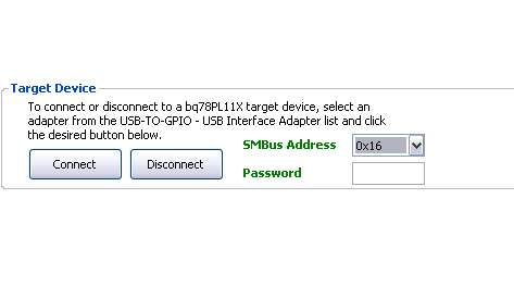

    I like to communicate with two BatterieManagement systems (Bq78PL114S12) over 1 SMBus. I already gave them two different addresses ( 0x10, 0x16). How can I select now the different BMS in the Software BqWizard?
    Best Regards Andy
  • When both bq78PL114S12 are commented to the bqWizard, the S/W will connect to the device with the lowest address first.
    Once you are done writing to thi device, you will need to go into bqWizard and follow the following sequebce to communicate to the second device:
    bqWizard >> Utilities>>SMBus Address to find the second device, pick its address and start communications.
    Ben
  • Hello Ben
    Thank you for your answer. The "SMBus Address" is inactive for search the address manual. if i just let the BqWizard search for the device (" Find" Button) it finds just the connected address.
    What else can i do?
  • Hi Andreas,
    Another option is to use the API Demo. This allows you to edit the SMBus Address.
    Or you could edit the bqWizard.ini 9ensure to save a copy of the original) file. Change the following line to the desired address
    ; bqWizard Target Initialization File
    ; **** WARNING: DO NOT EDIT THIS FILE ****
    [Calibration]
    [Setup]
    ; 0 = MCC Dongle
    ; 1 = USB-TO-GPIO
    Communications=1
    ; 0 = SMbus
    Protocol=0
    ; Value in decimal (7 bit)
    Address=11  <<<<<------------ Change the address to desired values
    Save the file and reopen the bqWizard. The default address will be the one you had saved.
    Hope this helps.
    Ben
