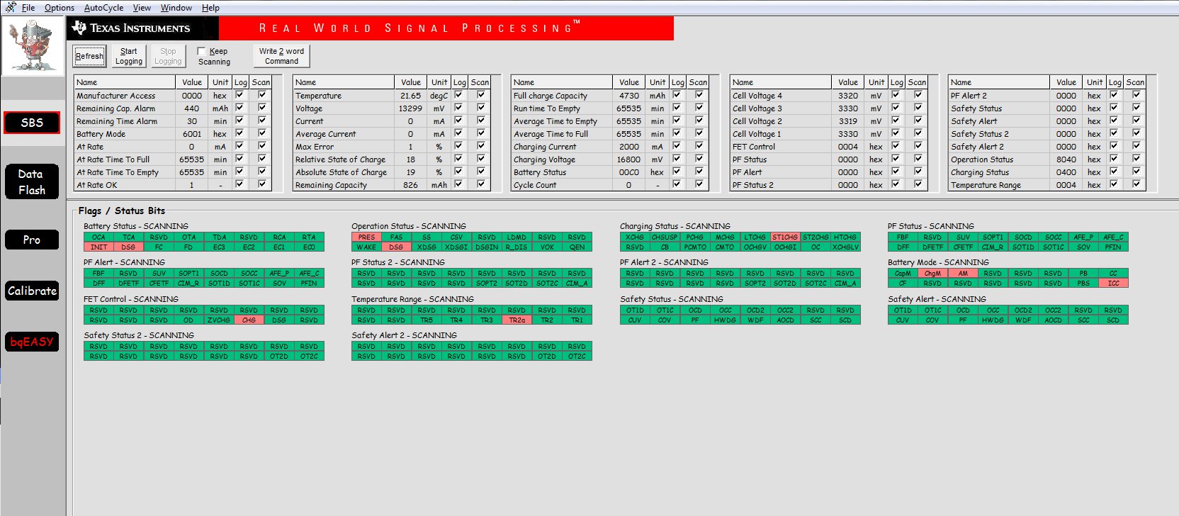

  • My guess is it is some sort of FET control problem, attached is a screen cap of the part that is in the system. The charger is removed, the part is in Discharge Mode but the CHG FET is still on and the DSG FET is off.
  • Pat,
    That screen shot shows that you do not have Impedance Track enabled, so the firmware does not have control of the FETs. Issue an IT Enable (21) command to see if that helps.
    Tom
  • Tom,
    Thanks for that it appears to have helped. So what should Update Status be set to in the Golden Image file now? I've read so many different app notes that say so many different things I'm confused. This is a system side Fuel Gauge.
    Pat
  • Pat,
    You should change the Update Status to 02 in the gg file to create the golden file. It will change to 06 after the IT Enable command has been sent.
