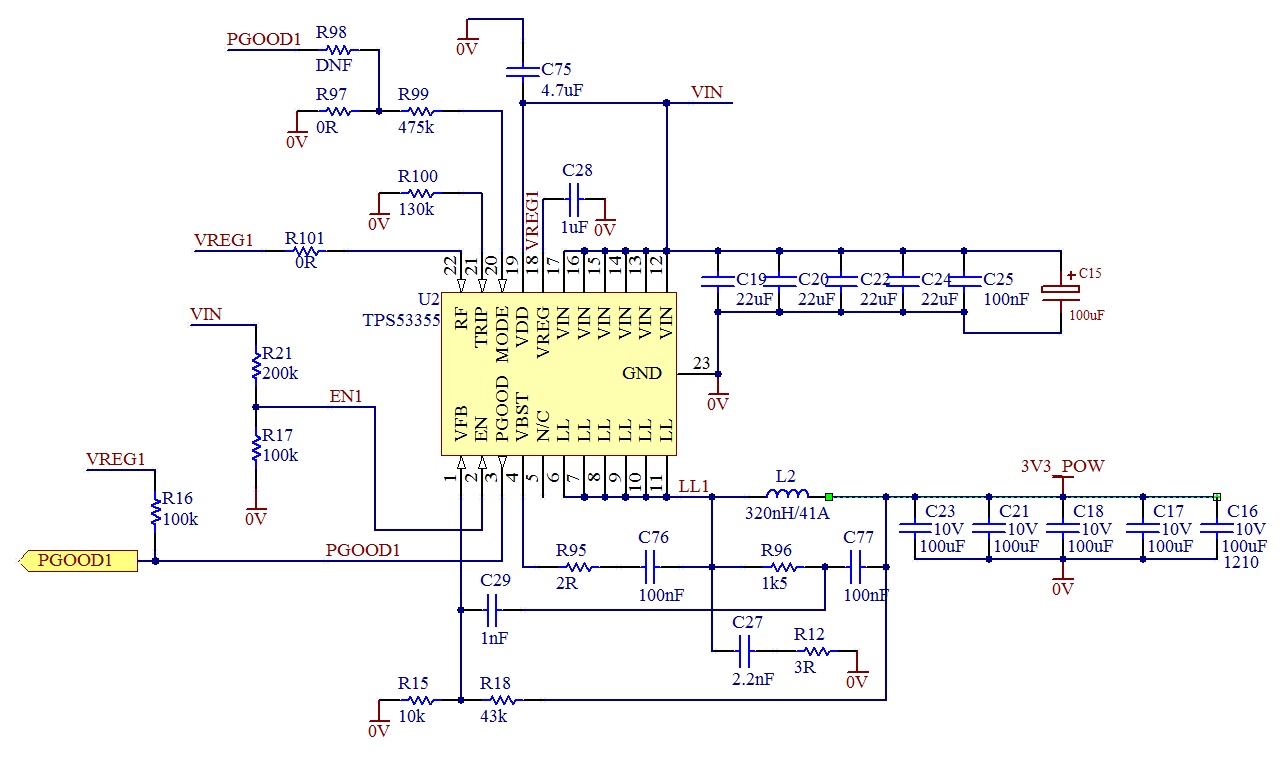

TPS53355 schematic confusion
Other Parts Discussed in Thread: TPS53355, TPS53353
Hi
I have a doubt regarding TPS53355 schematic. The application circuit diagram in the datasheet is showing that there is a series RC connection between ‘LL’ pin and Ground. However, in webench that RC network is connected with Vout instead of GND (see the attachment). I want to know the purpose of this connection.
Kunal
TPS53355.docx
