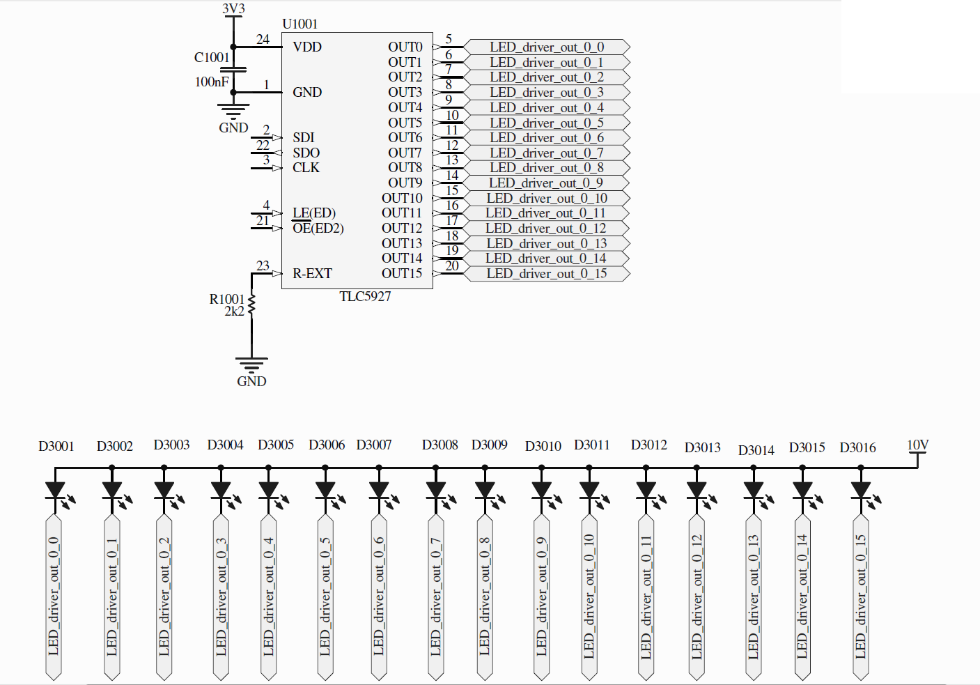

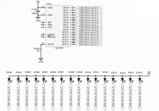

We are developing a simple LED circuit and are experiencing a bit of a problem with TLC5927 device. We have created a serial protocol by using GPIO. We can control LEDs as well as brightness by entering special mode. The problem arrives when we try to read error status codes.
Here is the problem: all 16 LEDs are connected and turned ON. The device ALWAYS reports '0' for all of the LEDs (e.g. error state). We have also tried to short circuit the outputs or left them opened as well. Everything that we tried yields '0'. Any clues?

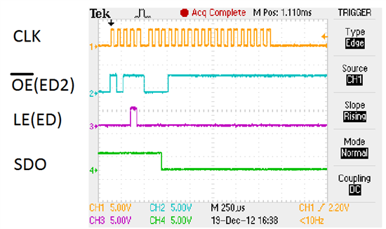

Bellow is a schematic and scope printout. We have also tried different R-EXT resistors (R1001 = 1k, 560R,...), but with no success. The datagram sent by TLC5927 can be seen in a scope printout. The GPIO pin is set to input direction, but data still remains '0' for all LEDs.

  • Matej,
    First, note that Error Code will be HIGH on normal and LOW on Fail or NO Detect.  Please see Table 1, Table 2 and Table 3.  You must keep OE low during the full testing of the Error or you will get the "Detection not Possible" LOW.  Please see Figure 13 for the timing.

  • Hi Dick,
    thank you for quick reply. I will comment what you have written bellow:
    'First, note that Error Code will be HIGH on normal and LOW on Fail or NO Detect.  Please see Table 1, Table 2 and Table 3.'
    We have turned all the LEDs ON. The 'NO detection' is therefore not logical state. Why we get '0', eventhough the LEDs are tured on and working, i do not know.
    'You must keep OE low during the full testing of the Error or you will get the "Detection not Possible" LOW.  Please see Figure 13 for the timing.'
    I see. The document also states, that 4 clock cycles in a 20us or more are enough. We have also tried 10 or more clock cycles with OE low but it didn't help.
    Please see the scope picture attached. I belive that the timing is in accordance with Figure 13.
    The problem is, that we have measured signals with oscilloscope and we belive that it is in accordance with figure 13 (see the attached picture). Maybe there is something we are no seeing here?
    Thanks for the support,
    Matej

  • Yannick,
    I do not have any code on error verification that I can send.
    Have you monitored SDO during normal operation to verify the SDO shows SDI delayed by 16 cycles?
    For an output to show the correct error message, the output must be turned ON and OE must be low (the LED should be on).

  • Hi all!
    We have tried a lot and at the end of the day it turned out that power supply voltage was the issue!
    We resolved this some time ago and as far as i remember, the OUT RTh parameter was the issue (check table in datasheet page 8). Basically it says, that you have to provide at least 2.2V on the driver the pin in order for detection to work. So, if you have a voltage drop of 3V on LED, you have to provide AT LEAST 5.2V on Vdd pin, or the circiut will say that you have shorted pins. The same was for open-pin detection.
    So all-in-all you have to find a range of Vdd voltage for your specific application. The main parameter for detection to work properly should be your LED voltage drop.

  • Hi
    We were having a similar problem, and worked out it was always faulting because the voltage between the LED and the TLC5927 was too high. Try changing the supply voltage of the LEDs so that the Vth is below 2.4V and then running the test again.
