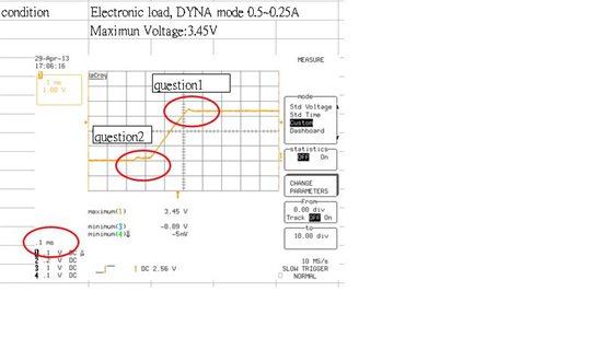

    question1
    I found out the voltage have a little bit overshoot when I using the LM2842XEVM.
    Actually I setting the voltage with 3.3v, but  it will overshoot to 3.48v.
    Please kindly let me know what the cause and how to improve on this. Thanks a lot.
  • Hi Ou,
    It's possible to add additional soft start to this application by bridging the upper feedback resistor with either a capacitor or other passives that disconnect following the soft start.
    See attached scan.4527.E2E Simple Switcher - Ou Garth.pdf
