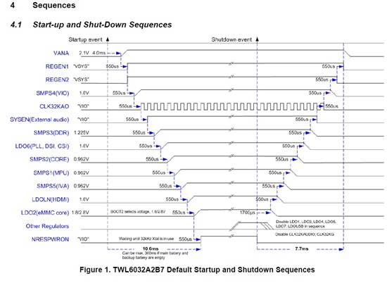

    I am also working with Hitesh on this TWL6032A2B7 Power On Sequence. As in below image from EEPROM Programming guide about Sequencing, we observed activity on Power rails as in the sequence up to LDO2. Last two "NRESPWRON" and "Other Regulators" don't show any activity. When we give momentary ground to PWRON input of PMIC, we are able to repeat the sequence as above.
    We think of PREQ1 bit EEPROM settings for TWL6032A2B7 has relation with above behavior of PMIC.
    As above, the power Up sequence does not get completed and we do not get stable supply on all voltage rails.
