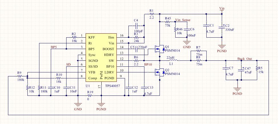

  • Hi Chuck,
    I'm currently having trouble to regulate to my desired output. Attached is the schematic of buck section. Once the IC start switching around 8V input, it only regulates at ~3V output. VFB voltage is 0.7V Switching frequency is correct around 300kHz. Did you encounter similar problems before?

    I don't think your problem is with the feed-forward network. I think your problem is with the error amp compensation network -R10, R9. You have the feedback resistor, R10 at 18K and the input resistor, R9, at 180K. The ratio of R10 and R9 is less than one, which makes the error amp a non-inverting gain block with a gain of 10, so that at 3.0V output the voltage at VFB is 0.7Vs. This is the only solution you can get if you have the error amp gain set at 0.1 inverting with a reference voltage at 0.7 V.
    Usually R10 has a capacitor across it to give the error amplifier maximum gain at DC.
    You need to look at the data sheet and follow the Loop Compensation design guidelines, section 7.3.8 on page 13.
    Chuck
  • Hi Chuck,
    Thanks for your quick reply. Yeah I realized that too. I just followed the slaa476 reference design and BoM that's why the value of R10. I just use R9 -180kohm to power-up the buck section. Now I will try to change the feedback network values.
