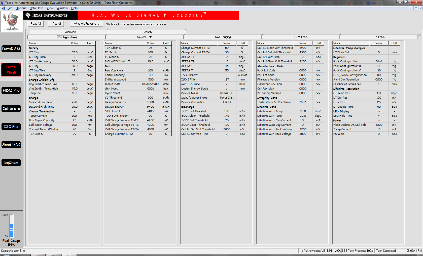

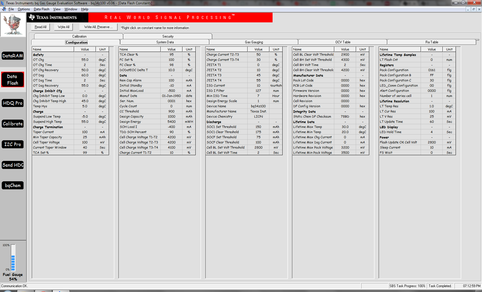

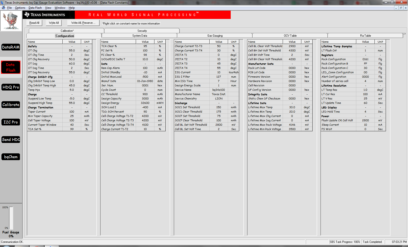

I am using the BQ34Z100 EVM with BQ Evaluation S/W , I am able to write to Control() from the data RAM screen but can't modify the Data Flash Contents , The following are the steps i took to modify data flash ,
To Modify Device Name :
Default Value :bq34z100
Change to : aaa
1>>Click "Read All " button ,then click on the Device name and edit to "aaa"
2>>Press Enter (When i do press enter the default value appears back in red in the same place)
3>>Press Write all Button ,the DF task progress goes from 0-100% 2 times and writes flash ,but i'm not able to change any value in the DF screen
Please provide a solution ASAP.

    I verified that I can update the Device Name following your procedure, so there must be a configuration problem on your EVM. There is not enough data shown to diagnose the problem, but it does show that you have the pack configured for one series cell and I doubt that the pack has been calibrated based on the Pack Configuration register setting. The Flash Update OK Voltage is set to 2800 mV, so the cell voltage will have to be above this limit to update the data flash. Do you have any error flags set?

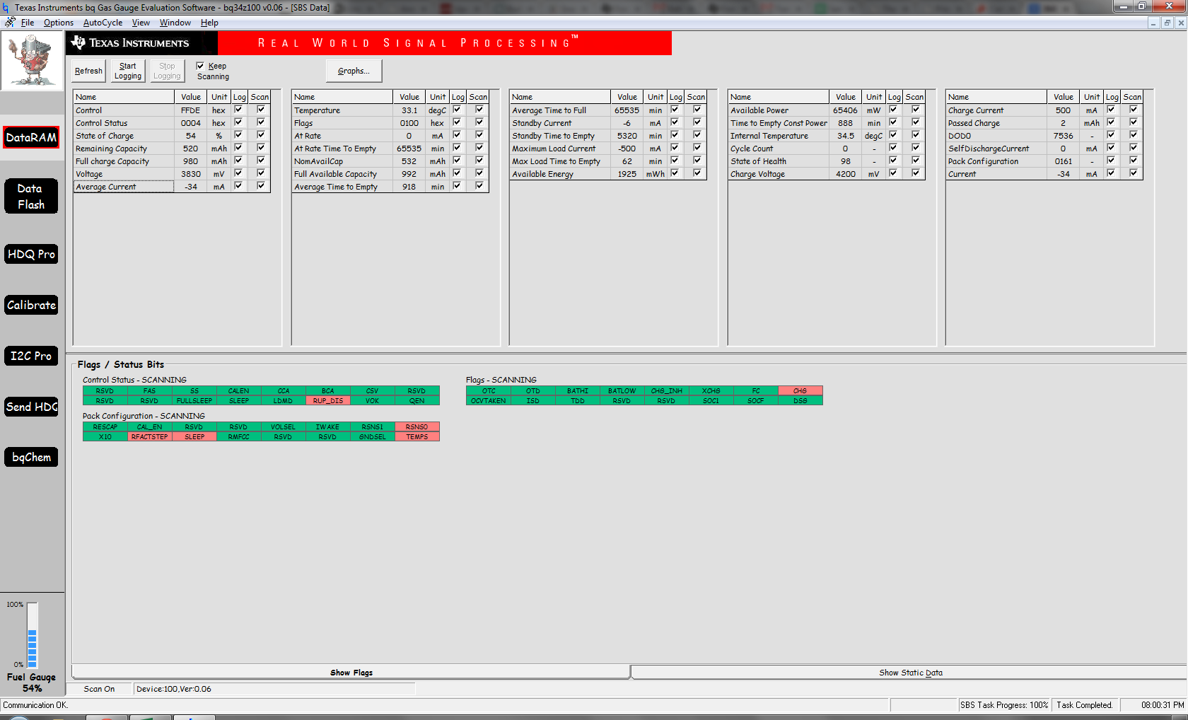

  • Hi ,
    I had changed the bqchip on the evm because of applying reverse polarity ,my evm was working with the evaluation software perfectly before ,i am trying to make the settings as before but cant update the flash contents , the following jumper settings have been applied ,I'm using a 15V 13.6 AH battery
    J1-  Shorted for I2C
    J2 - 16 V
    J3 - A
    J4 - open
    J5 - Both Multicell are shorted
    J6 _ A,B,C,D are shorted
    J7 - connected to EVM2300 I2C port

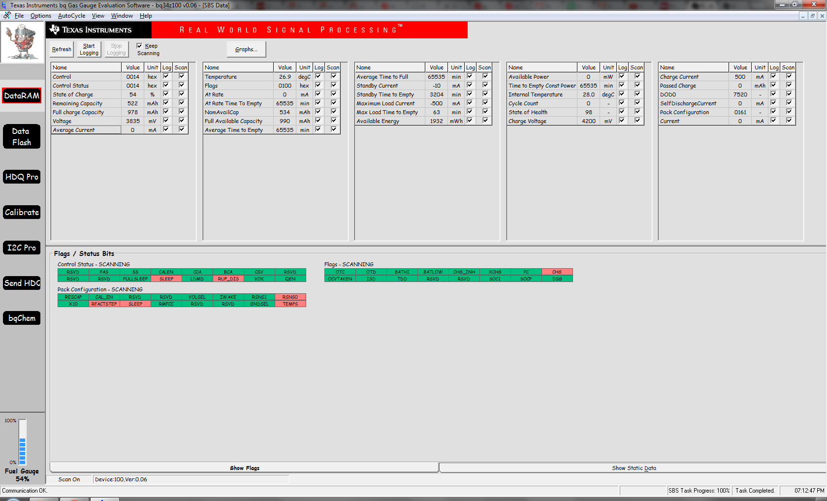

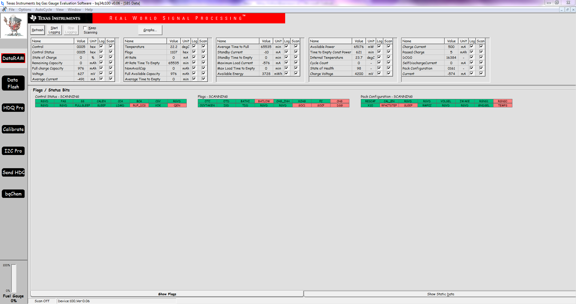

    The same settings were used previously , find below the screenshot of the dataRam screen for the errors
    Abhay
  • Abhay
    That is the same configuration that I have been using. Can you reload the senc file to make sure that the firmware is okay? If that does not help, then I would try configuring the EVM for single cell until you can get access to the data flash and calibrate the device. You should also check the signals at the device pins to make sure that the reverse voltage did not damage something else on the EVM.

    Since the device is communicating with the GUI and i'm able to use Control() on the Data RAM screen to place the device in sealed mode and unseal it back using the control i guess the I2C is fine , I have another question
    The BQ goes into sealed mode bits FAS and SS are set each time the device gets reset after sealing the device once, note that i did not reset the device when it was sealed the first time ,rather i unsealed it and then tried a reset,why does this happen and is there any way to prevent this.

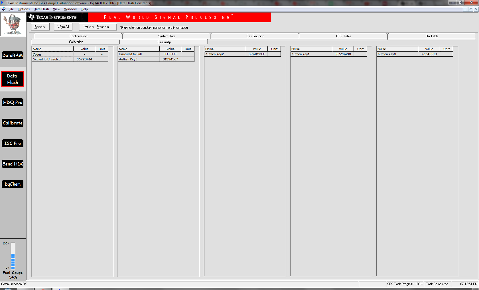

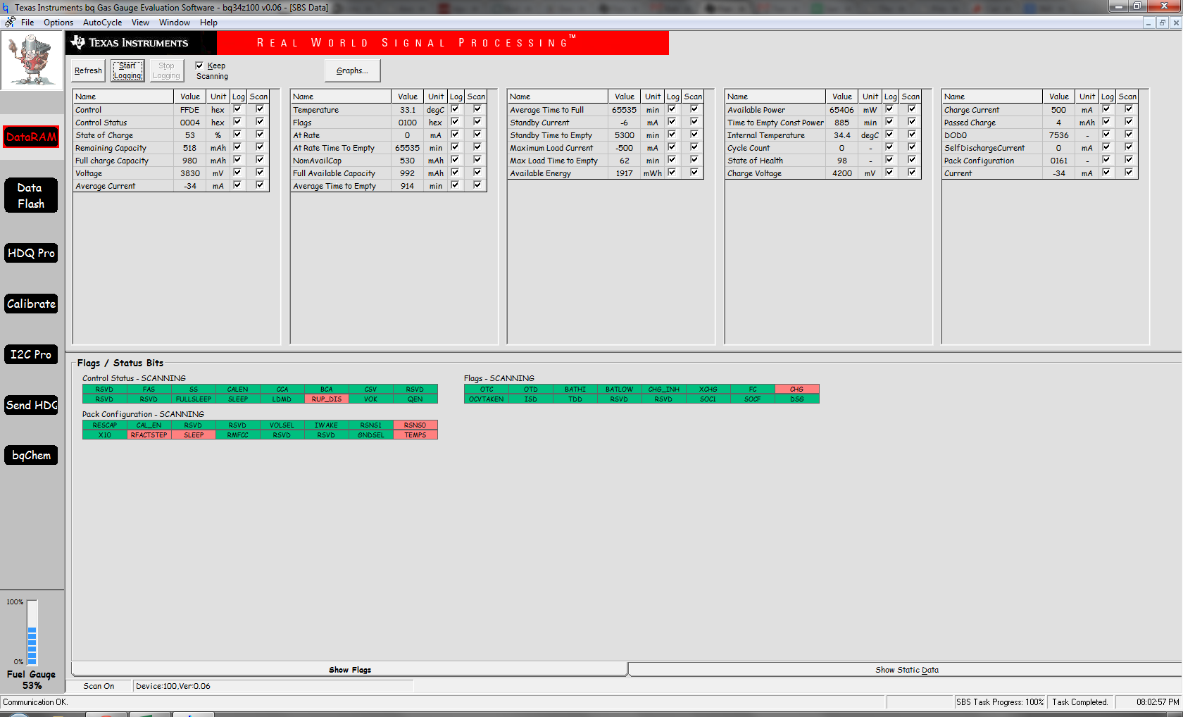

    I have attached a few screen shots. I tried using the unsealing and full access process based on the datasheet but could not change the control Status. I am attaching a  few screenshots. I have checked everything mentioned on this post already I believe I am not following the process to unseal correctly but I have not been able to figure out what I should be doing.
  • The data provided indicates that the device is not sealed, so you do not have to sed the unseal and full access codes. The program recognized the device, so that is good. (assuming that you are using a bq34z100) Have you calibrated the device yet?

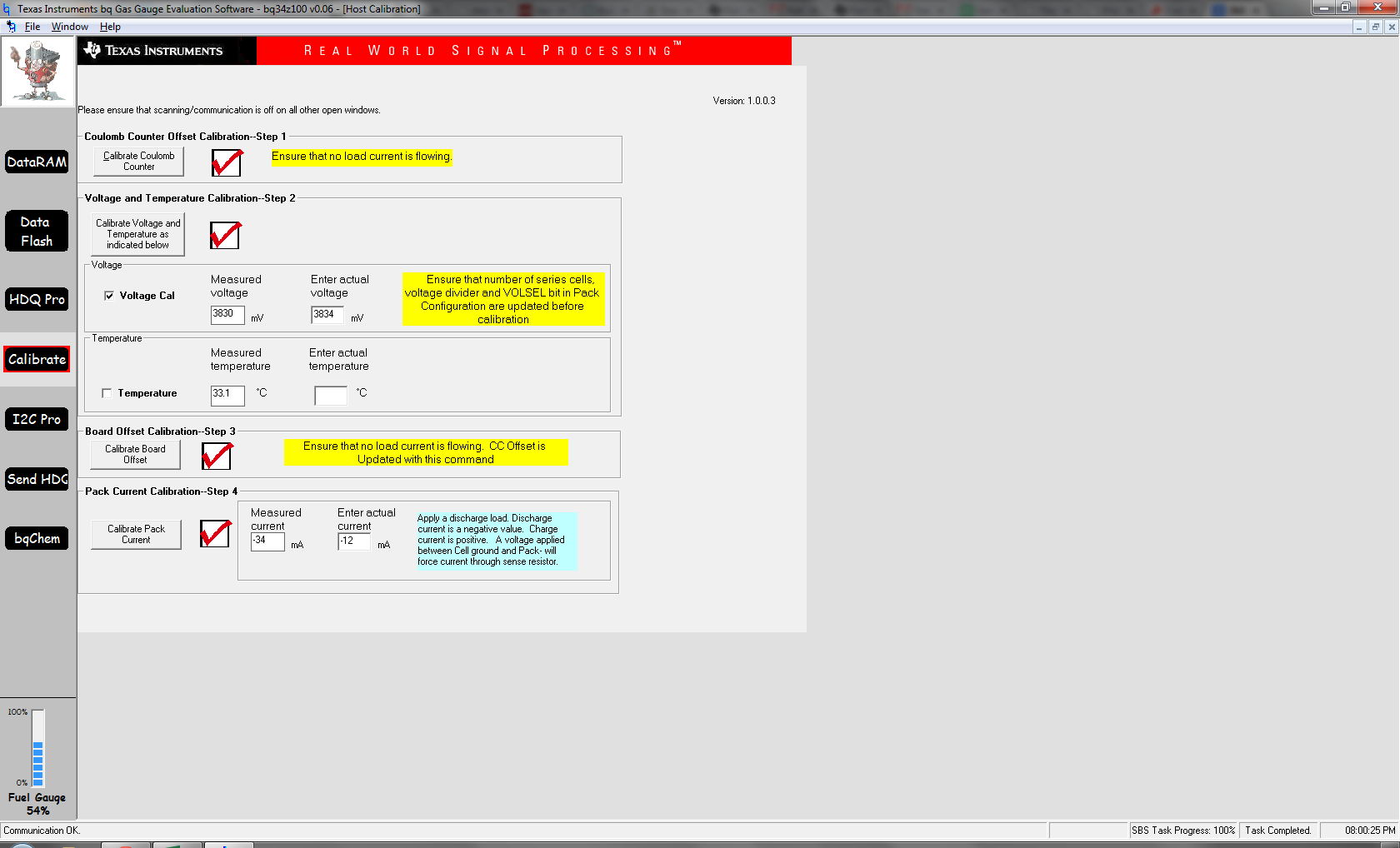

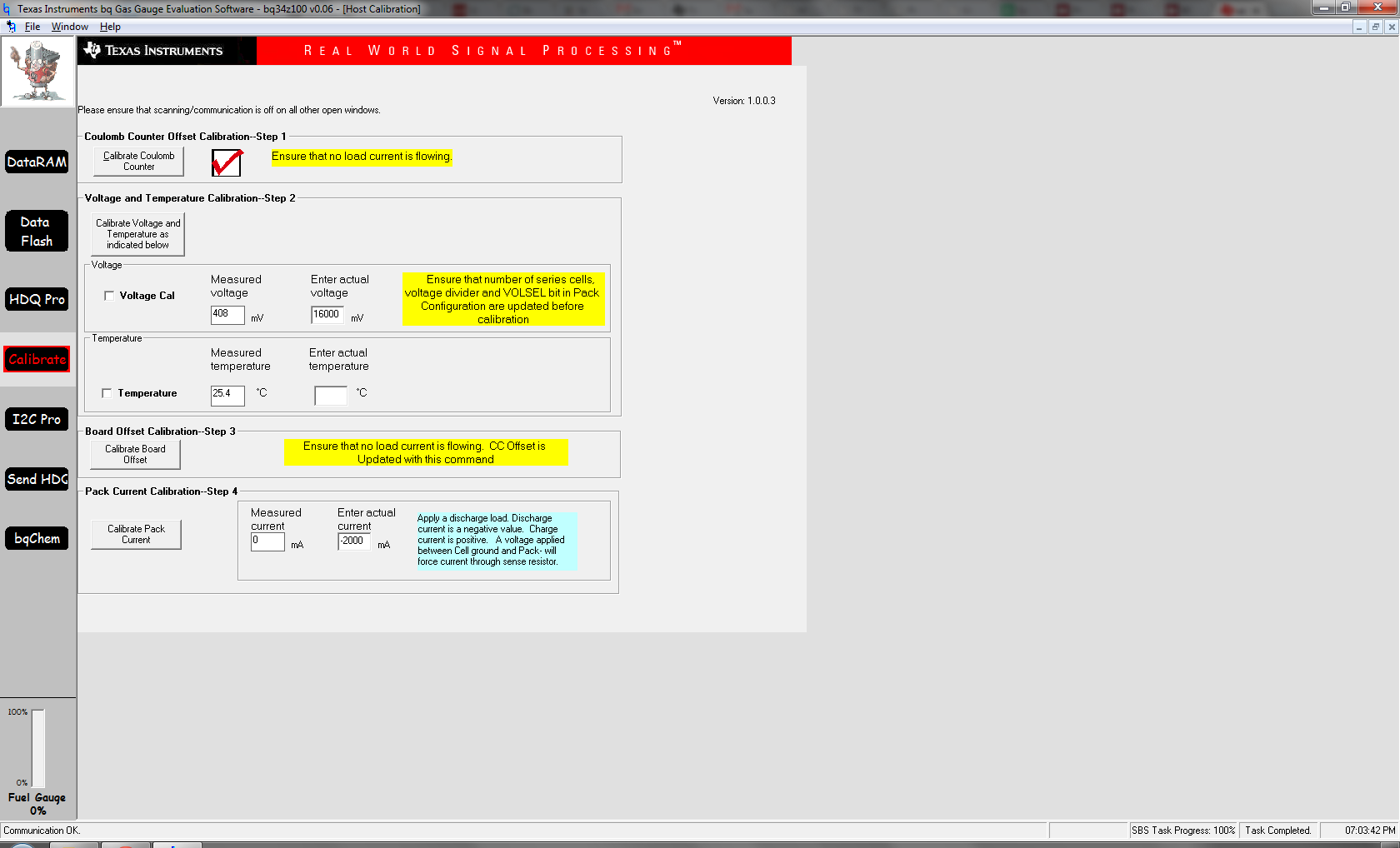

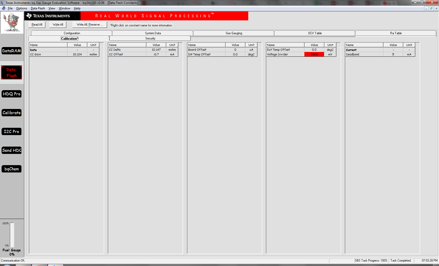

    I was following the steps from the datasheet page 29 and I checked that the number of cells is configured, VOLSEL bit is set and then I tried to change the voltage divider value to 16000 but it gives me a red cell with 5000
    Here are the screen shots.
    The coltage measured in the calibrations is below 1V for some reason.
  • Tom,
    Did you get a chance to look at this? Any ideas why it would not be measuring the 4 cell voltage correctly?
  • Your screen shot shows that IT is enabled. You should not enable IT until the parameters have been configured and the pack has been calibrated. I have seen this cause the device not allow data flash changes.

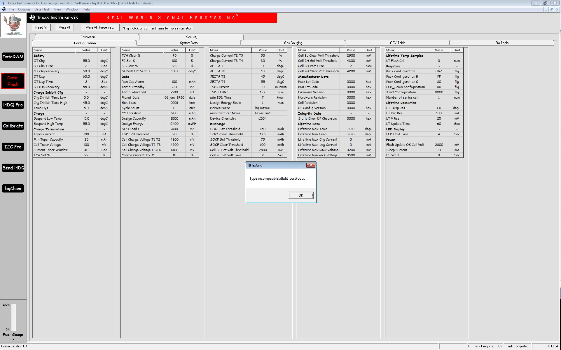

    I've just received the bq34z100 evaluation kit with the EV2300 interface. I've configured the board for my 6 cells battery as mentioned in the data sheet 8and in the previous posts). The software can read the status correctly, communication is OK.
    But now I can't do anything but reading the chip. Every time I change a value (even leaving the same value) I have a pop-up window like this:
     and no value is changed. I've followed the steps mentioned at page 29 of the data sheet.
    I've also tried to reload (successfully) the senc files you mentioned in a previous post with no change.
    Please help...

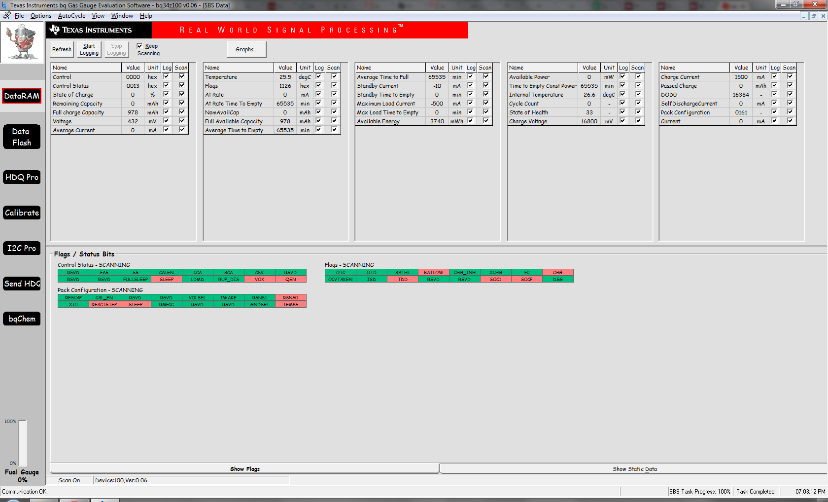

    As I am unable to change the voltage divider and the calibration measured voltage reading is below 1V, I am unable to calibrate and get 0% battery all the time. The pictures above have all the information (IT not enabled)
    Anything wrong with the steps I am following? Any other hardware changes required except the change in jumpers?
  • Rishabh
    Your process looks okay. Don't worry about setting the voltage divider parameter. Also, make sure that you press the <enter> key on the computer after you change each parameter. The value should get saved into flash at that point. If you cannot change parameters after reloading the senc file and changing the # of cells and VOLSEL, then something must now be working right in your bqEVSW or the device is damaged.
    Tom
  • I have two devices and both give the same result. I am able to change all other parameters but have trouble changing the voltage divider.
    Even if I don't change the voltage divider there is no way I can calibrate as I am seeing 923mV in the measured voltage on the calibration screen and without calibration I see 0% battery remaining all the time.
  • Can you provide a picture of your setup? Maybe I can see something setup incorrectly. What voltage do you have applied to BAT+? Do you have two EVMs exhibiting the same issue or did you just replace the device on the EVM? I thought that maybe another component on the EVM is defective.
    Can you export a gg file while it is still configured for 1S, change the parameters and import the changes back into the device? You will have to press the Write All button after importing the file.

  • Gabriel,
    That is not an error that you should receive, so the bqEVSW that you are using my have a bug. Did you download it from the TI website? Please provide an email address and I will send you a link to download a new setup file.
    Tom
  • Dear Thomas,
    Yes, I've downloaded it recently from TI website. Version is 0.9.90. I've just downloaded it right now to be sure and the same error appears. I've tried on a old PC with windows XP and another one with Windows 7 with the same error.
    The evaluation board is new and no bad manipulation has been made.
    Please send the right version to info(at)gxe.ch. Hope it will fix the problem...
