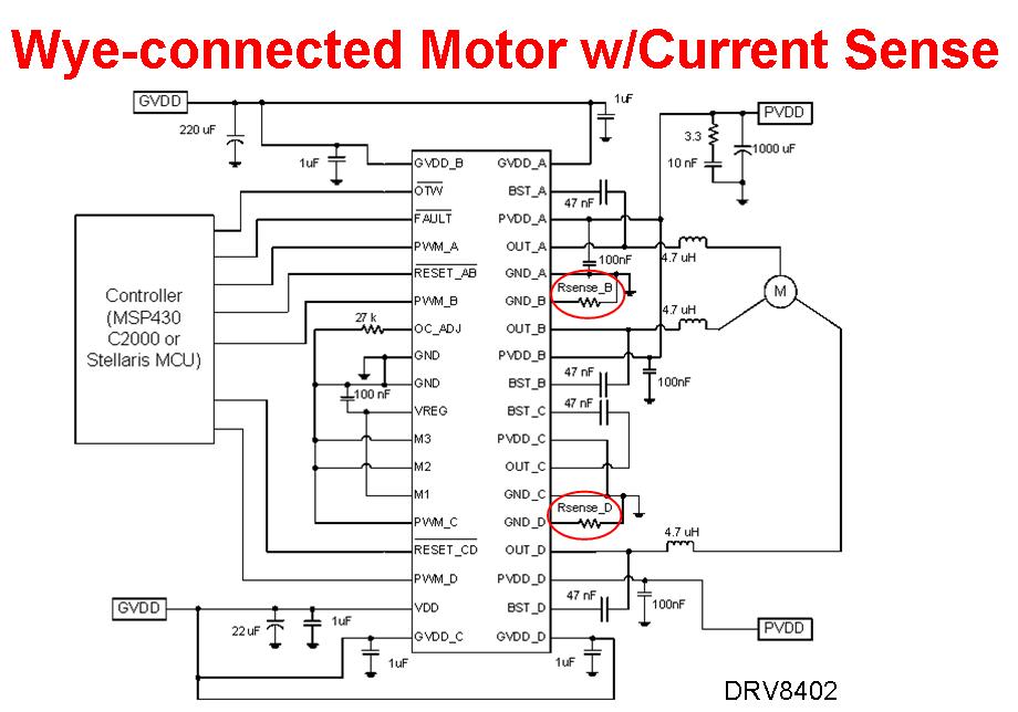

 I hope I am in the right section for this post.  I intend to use the DRV8402 in a stepper drive application where the stepper current will be around 3.5A per phase.   I was curious about the inclusion of inductors in the datasheet discussion and the EVM.  Why are they needed and more specifically would they be needed when driving a stepper that would have 2.65 mH per phase.
 I intend to configure the DRV8402 in full bridge mode. Would I be able to place a current sense resistor in the GVDD _B and GVDD_C lines to control the current in the stepper motor.

    The output inductors are used to limit the current into our IC in case the outputs are shorted. Without them, our output current limiting won't work, and you will let the magic smoke out of our IC (eg, it will be fatally damaged).
    You can sense current -- I need to find the reference schematic for that. I will post it later today.

  • Hi, Peter,
    Attached is a drawing that shows how to sense the current --> note, you need to keep the voltage drop across the sense resistor to be less than 0.3V, or you may cause problems with the IC.

    We currently use IR2104 and IRF540 FETS in all of our present stepper drives. we just came across the DRV8402. The specs sure look very promising.
    Don, You mentioned that the voltage across R_sense should not cross 0.3v. is it an absolute limit or more like the safe limit? I'm asking coz currently we use two 0.1 Ohm 5 watt resistors in parallel as our sense resistors for each full bridge. So using the same sense setup considering the 0.3V limit you suggested the drive can go up to 6A. Will this setup be able to work flawlessly at 0.3v or do we have to stay 5 or 10% below 0.3v for flawless operation?
