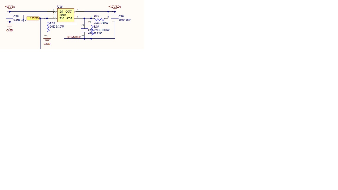

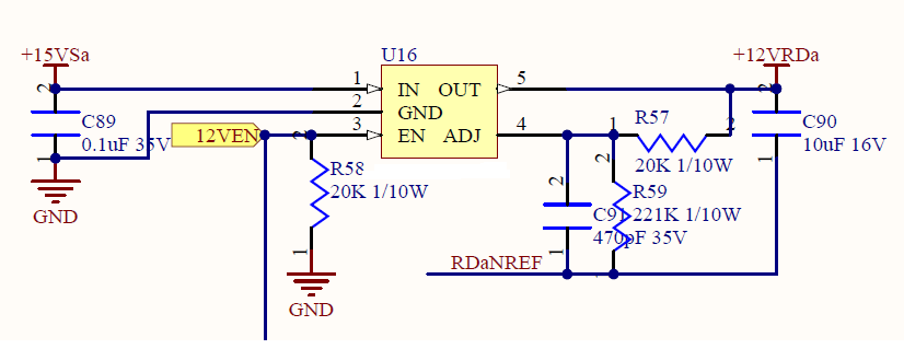

I plan use DAC to adjust the LDO output from +13.7V to +11V.
Do you think I am in the right track?
