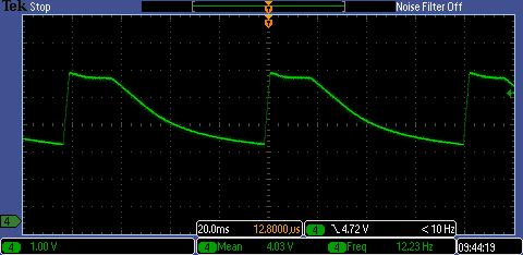

  I'm following the PMP8286 (http://www.ti.com/tool/pmp8286) without the secondary USB charging. However, when I try to source 150~200 mA from the output, the voltage start dropping like this.(from 5.2 V to 2.8 V)
Therefore, the output current cannot sustain at 150~200 mA. If I increase the load above 200 mA, the circuit works just fine. The output holds at 5V. Any idea?

    UCC28700 can give min 1Watt and max 20Watts.
    I guess the issue is related to this.
    try adding a bleeder resistor to the output

  • If you look at PMP8286 or datasheet, the current sense resistor limits the maximum current output. In this application, it should provide 10 W max only. However, in my experiment, I went to 12 W but the output still not cut-off.
    For the low-loading problem, I solved this by increasing the current sense resistor. According to the tools or datasheet provided, the Rcs = 1 ohm if you want to source 2 A maximum. I increased to 1.3 ohm and the low-current voltage drop goes away.
